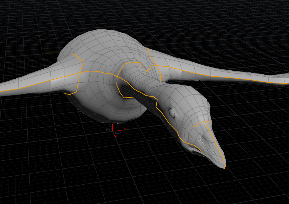

I am trying to unwrap a goose model. I have watched the tutorials on using UV Flatten but none of them cover what makes the best choice for edge selection. I need to generate UVs for a texture paint program but when I get to the painting process there is never enough detail in the UVs to support high quality texture mapping.
How do I unwrap a goose so I have the most detail in every portion of the body, especially the head/face area?
The image shows my current edge selection which does not produce very good results.
Edge Choice For Best Unwrap?

You probably don't want those meridian cuts on the head/neck, instead use a sagittal cut for the head, and a transverse cut through the neck to separate the head/neck. The neck can be unwrapped with a single sagittal cut, either on front or back. The inside beak and nostrils should also probably be cut along their perimeter.
http://teachmeanatomy.info/the-basics/anatomical-terminology/planes/ [teachmeanatomy.info]
