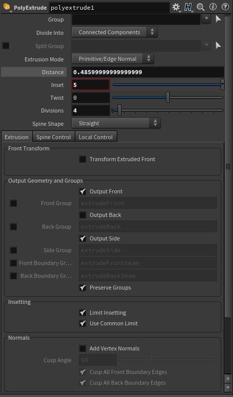

I had a group attribute named “chunks” on some primitives. After the PolyExtrude (with preserve groups option) I see that the groups are only preserved on the front faces but not the sides. anyway to fix this? Is there an option I'm missing?

I've run into this problem a few times and it always brings me back to this forum post. Setting Extrusion Mode to Point Normal doesn't resolve the issue for me, but Olivierth has another post here: https://www.sidefx.com/forum/topic/61089/ [www.sidefx.com] that seems to have a good solution.
Short answer: Use attributes instead of groups as they will be preserved after the extrusion.
