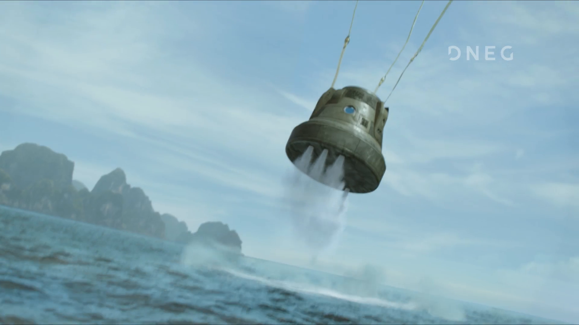

Hi guys,
I'm having a bit of a rough time trying to recreate a cool steam-like thruster effect I saw on a shot from the most recent Houdini customer reel: https://media.giphy.com/media/2sYerbT6O0wzsLXfK2/giphy.gif [media.giphy.com]
I'm having a lot of trouble shaping my pyro. Either I get a very noisy emission without the look of the cone emission, or I'm just getting a much to noisy/wispy look in the bottom section of the sim. I just can't seem to get that perfect balance between feeling powerful and still looking like it's in control.
If anyone has any tips and tricks or any example files/tutorials that might help out, please feel free to point me in the right direction. For anyone who's also interested, I've attached a cleaned up hip file as well. If I get any further with this in the coming days, I will make sure to update my progress.
Cheers

As promised, here is an update. After trying out Enivob's method, which worked really well for what I was initially asking, but just wasn't getting me the results I needed. I chose to instead split the pyro sim in two, separating out the upper “cone” shape from the lower puffier smoke and then just merged them together. This allowed me to cheat-shape the pyro and got me closer to my reference. I'm still a bit off, but below is my result.
