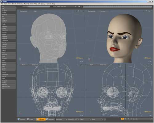

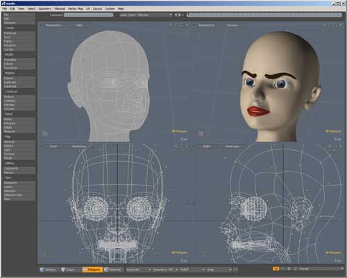

268 posts
picture is worth a thousand words … when viewed as subd the base cage assumes the shape of the subd version and you can edit points on that version. For render you'd switch to your base cage but when rendered as subd surface it will pretty much look like what you saw in viewport.
At the moment you can sorta duplicate this workflow by putting down a subdivide sop, looking at your base cage in wireframe and templating the subd version and showing it as smooth shaded. Though you are still picking points on the rough base cage and things get pretty slow pretty fast even with fairly low res geo.
