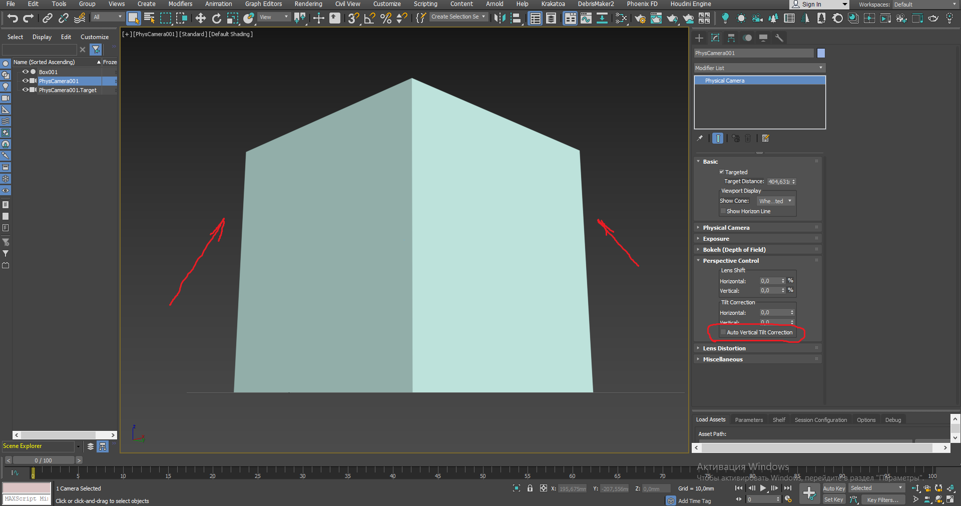

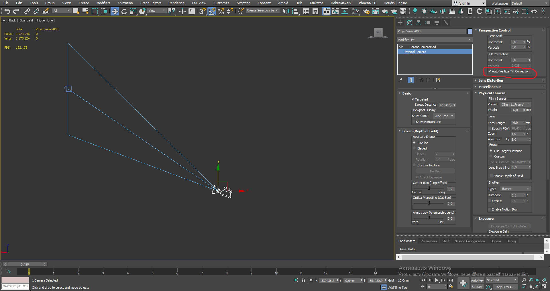

The question is, in 3Ds Max there is a checkmark in the “auto vertical tilt correction” camera, is there a similar one in Houdini?

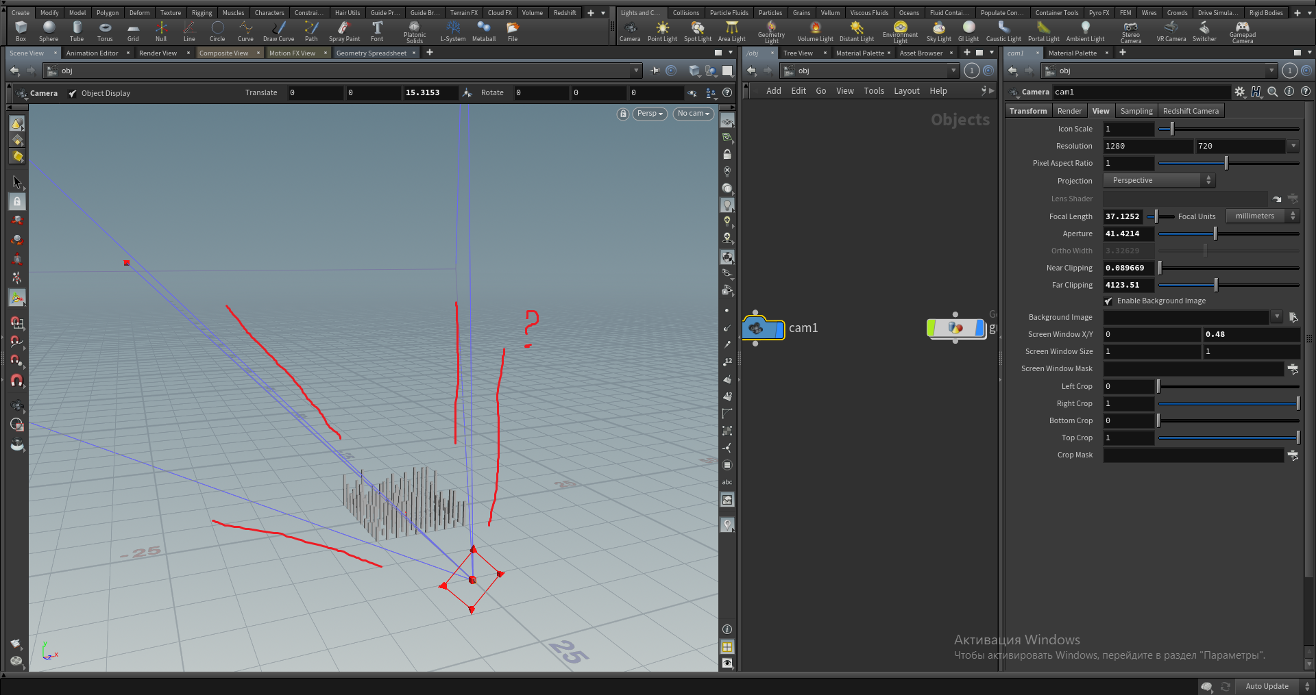

On the camera parameter View tab, try adjusting Screen Window X/Y's y parm, and then adjust the cameras Y Transform to frame the view. Its basically the same but not as straight forward as the Max button

t makes no sense to customize Screen Window X / Y's. Can you show where to configure “and then adjust the cameras Y Transform to frame the view”?

To get the frustum, RMB on the camera and select Frustum Handle

Sorry, but your method does not work, in some special cases it may be, but something else is needed in architectural animation.

if i had to guess, it looks like it's actually skewing/shearing the camera matrix in one axis. so the short answer is that no, houdini can't do that out of the box. it would be possible to do it in a mantra lens shader, i imagine. but nothing you could see in the viewport.
max is full of special archviz stuff like that, which other packages don't have equivalents for.

It's basically the CG equivalent of this technique:

You can calculate the shift amount from the tangent of the tilt angle and the ratio of the aperture to focal length. The y shift has to also be multiplied by the aspect ratio.
The hard part of automating this with a rig is figuring out what a ‘tilt’ is, and removing it from the transform.

Even if it's very easy to set it manually (set camera rotation X to 0 and adjust the “screen windows” Y), an automatic function would be cool.

It's available in Houdini 19 (possible even as early as 18.5), it's called "physical lens" in Solaris, and does a couple of interesting things, including tilt/shift.
In your LOPnet, put down a material library, add a physicallens VOP and reference that as the lens shader VOP from your camera (it's under the "karma" tab).

I don't see lens shaders ever being supported in a gl view, unless the gl view uses raytracing extensions. it's just not possible to control the imaging with a lens shader when rendering with rasterization.

Vertical/Horizontal aperture offset is what I would use. The lens shader is overkill for a simple 2D transformation.

Use the window offset to shift the image. You don't need to extend the image. Window offset is on the View tab of the camera object.

Aperture offset is the USD term for window offset, and is only used in Solaris/LOPs.
