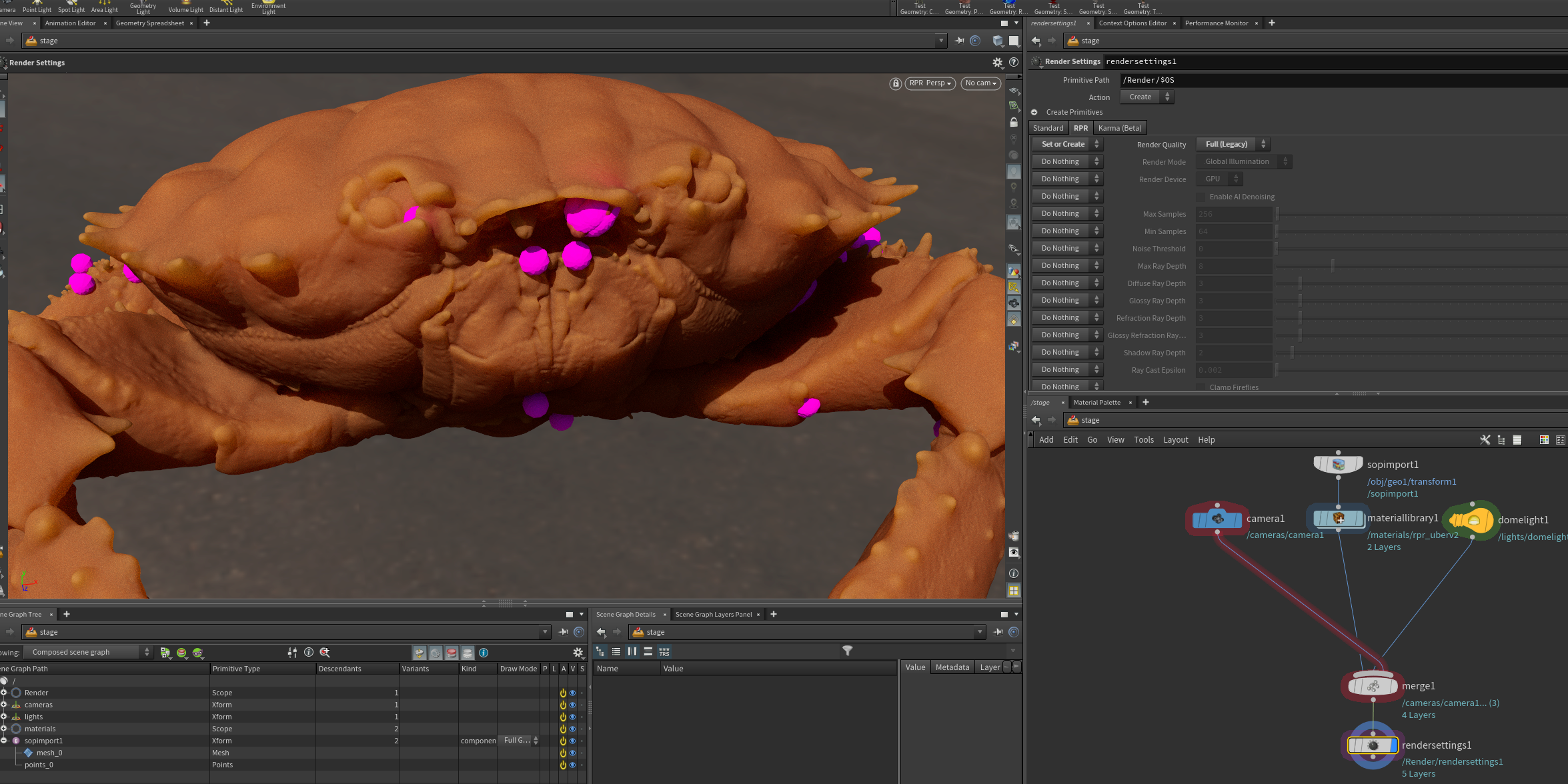

Also, I noticed something interesting when using a model with bad geometry and SSS; some weird pink sphere appeared using Full(Legacy)
First image is clean geo SSS Full(Legacy)
Second image shade view of the geo
Third image is bad geo SSS Full(Legacy)
I'm not sure we have to worry about the bad geometry case. But anyway, can you share the bad geometry case, I will take a look
I'm not sure we have to worry about the bad geometry case. But anyway, can you share the bad geometry case? I will take a look
I don't think either but it took me some time to realize the geometry was the problem. Here is the obj file and the hip file.

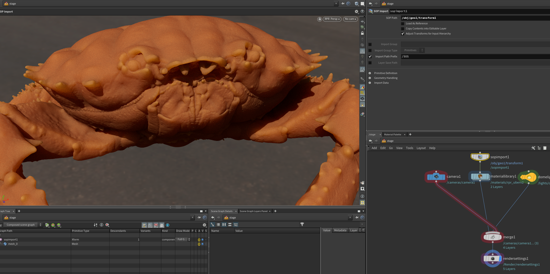

Actually, it is not about geometry at all but how Houdini imports mesh with/without the clean node.
With the clean node:
Without the clean node:
As you can see, for some reason, without the clear node there is HdPoints primitive. This primitive has no radiuses and material that's why it's rendered with the default radius 0.5 and pink color.
Edited by hshakula - April 20, 2021 18:34:40
Hmmm, that's a little bit weird good catch. I was more focused on getting the SSS working.
273 posts
Joined: March 2013
that's not got to do with how Houdini imports geometry though.
Those points are disconnected from the mesh, which points to the mesh being not checked/cleaned when it
was authored. This is annoying common in scanned geometry.
