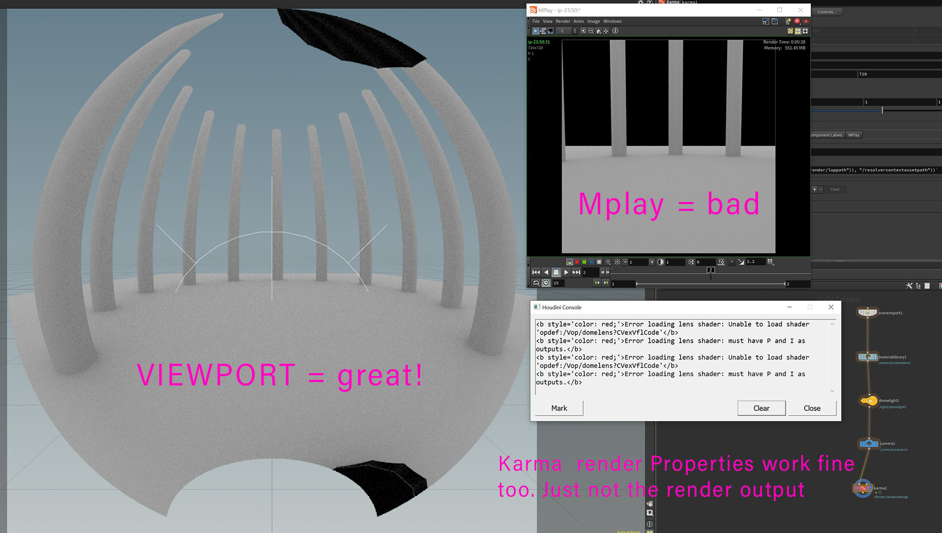

Hi Jeroen,
By any chance have you had a look at another CVEX domelens shader for Karma in 18.5? I don't seem to able to copy it from SHOP to LOPS. I can get your shader to work the viewport (which in its self is amazing- almost realtime fisheye!) but errors when I render through Karma or MPlayer.
Regards,
Max
135 posts
Joined: Aug. 2014
Hi maxecrow,
I haven't had a chance to take a look at the new Houdini 18.5 physical lens shader to see if it can be used as a dome lens.
It's great that you were able to get Matt Blackell's fisheye lens shader to work in the viewport!
Any chance you could share the hip file with us to study?
Many thanks,
Jeroen
Jeroen
13 posts
Joined: Oct. 2018
Hi Jeroen,
I didn't do anything special, I just I created an asset and pasted your code into it. I'm not sure how Matt exposed the fov or set it svalue to 180. It kind of works but I get this error...
<b style='color: red;'>Error loading lens shader: Unable to load shader 'opdef:/Vop/domelens?CVexVflCode'</b>
<b style='color: red;'>Error loading lens shader: must have P and I as outputs.</b>
Maybe this is something up Mr. Paul Ambrosiussen's street?
lens-shaders-for-gamedev... [cgsociety.org]
MOGX_031_Karma_hda_01.hiplc (502.1 KB)
13 posts
Joined: Oct. 2018
Karma render properties work fine too. just not Karma Render ROP
