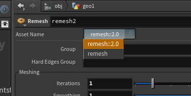

or you could use the v1.0 of the remesh Sop instead if the 2.0

or submit bug if it's still happening, because last thing I remember this was supposed to be fixed in 18.5.612
Houdini 18.5.612 Fixed a bug in Remesh 2.0 which caused degenerate triangles around boundaries and hardended edges. Thu. June 17, 2021
