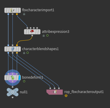

Hi, I have a rigged character with blendshapes.
I can play blendshape animation by Character Blend Shapes SOP, and edit by Attribute Expression SOP.
Anyway, I cannot find a way to export these blendshapes to FBX file.
I tried to use ROP FBX Character Output SOP. But I cannot play blendshapes animation with FBX file exported.
I realized that “blendshape_channel” and “blendshape_name” primitive attributes disappear after exporting.
Manual says “The KineFX export nodes preserve all blend shape data.”, but I could not succeed.
https://www.sidefx.com/docs/houdini/character/kinefx/blendshapes.html [www.sidefx.com]
Is there a way to export FBX with blendshapes in KineFX workflow?
Thanks.
