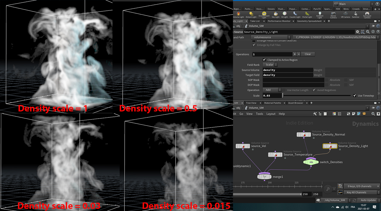

The Density solution is not perfect because it doesn't just increase the transparency of the smoke, it also alters its shape. I'd like the shape to remain exactly the same while becoming half visible. Check attached pics.
So the best solution might be the compositing one.

Yes, don't alter the density in your sim. This affects threshold lookups and your sim will look different. In general, the values going into pyro should be normailized 0-1.
Either do what Enviob suggested, or adjust the density in your shader, or use a Volume mix SOP which gives you a ramp to remap the denisty field.

Hello mr CatFish, thanks for the tips!
After some more test back in the basicsmoke shader , I found out that the "density Scale" slider does what I was looking for!
