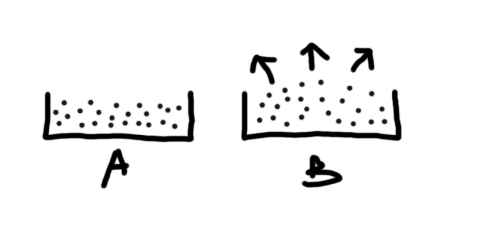

Tomas, I did try that method, caching the settled sim, but it really freaked out when I started the new sim from it. Particles flying all over the place. Perhaps it needs more substeps in that case?

Thanks, just tried that, but it still bounces upon starting up again. Save settled sim A and then first frame of new sim B moves up. It's the same collider on both, but it feels like when the new sim starts it's like it's overlapping something and trying to fix itself? Not sure.

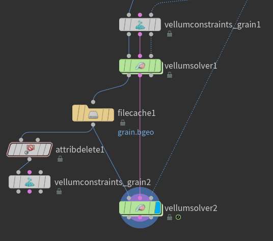

Here's a very pared down HIP showing the problem. I'm sure I'm missing something simple, but I tried a bunch of stuff and I don't understand why it's not working. Settled sim cached out, new sim started up with attributes reset and it explodes higher upon starting.

Possibly due to the doubling up of vellum grain constraint creation? If I plug the first settled result directly into the second vellum solver it behaves after an initial few frames of settling. Not sure if it's necessary to feed in the constraints between solvers as they're already defined, but at least this doesn't explode.

Arvan
Oh sweet, that works great. Somehow I got the idea that it needed to have a fresh grain constraint for the cached file.

BrianHankeusually you may want to Vellum Pack geo and constraints, cache that and then Vellum Unpack after, so that the constraints are cached also rather than having those plugged from live stream

tamteBrianHankeusually you may want to Vellum Pack geo and constraints, cache that and then Vellum Unpack after, so that the constraints are cached also rather than having those plugged from live stream
Great tip, thanks! I'll do that.

Thanks to all your help, plus a little experimenting, I got a very nice result in the end. Quite happy with the clumping here. I cached the settled particles, put all the unaffected ones to sleep, created a very low res version of the fern geo for collision, and got the sim time down to 5-10 seconds per frame. Much improved!
