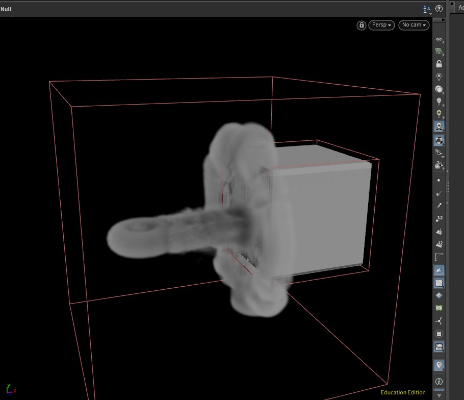

studying Tamte`s file helped me.
my problem was:
The name of the vdbfrompolygons-> Distance VDB (default is surface)
did not match the the name of the pyrosolver-> Collision->Collision SDF (default is collision).
If the name attribute does not match, it still works on creation, but not after working with it.
Just set both name fields to collision ...
THX and Cheers
