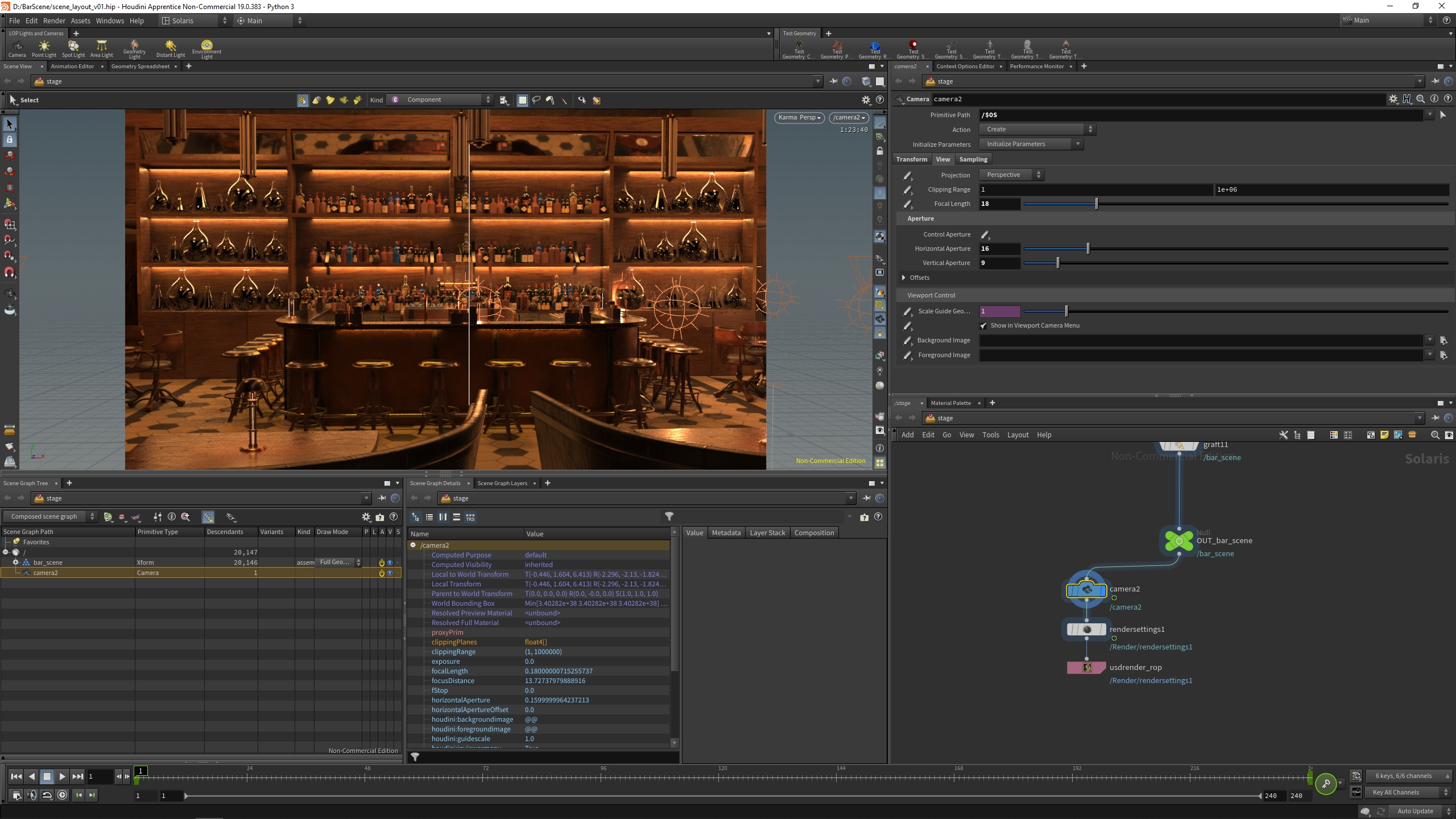

I am testing Houdini 19 XPU render with the bar scene, it took 7M 44S to render with XPU on an 8cores AMD and a GTX 1650 with 4GB of VRAM, some bits don't seem to work and I get an Optix error, but it's darn fast, CPU 1H 23M 40S, but much cleaner render, but still, XPU is very promising indeed!
I made a second test and I am sharing the scene file on this post:
https://www.sidefx.com/forum/topic/81348/#post-350453 [www.sidefx.com]

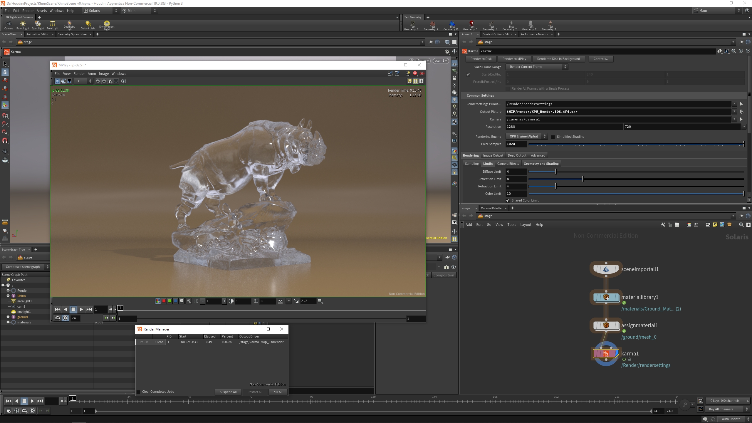

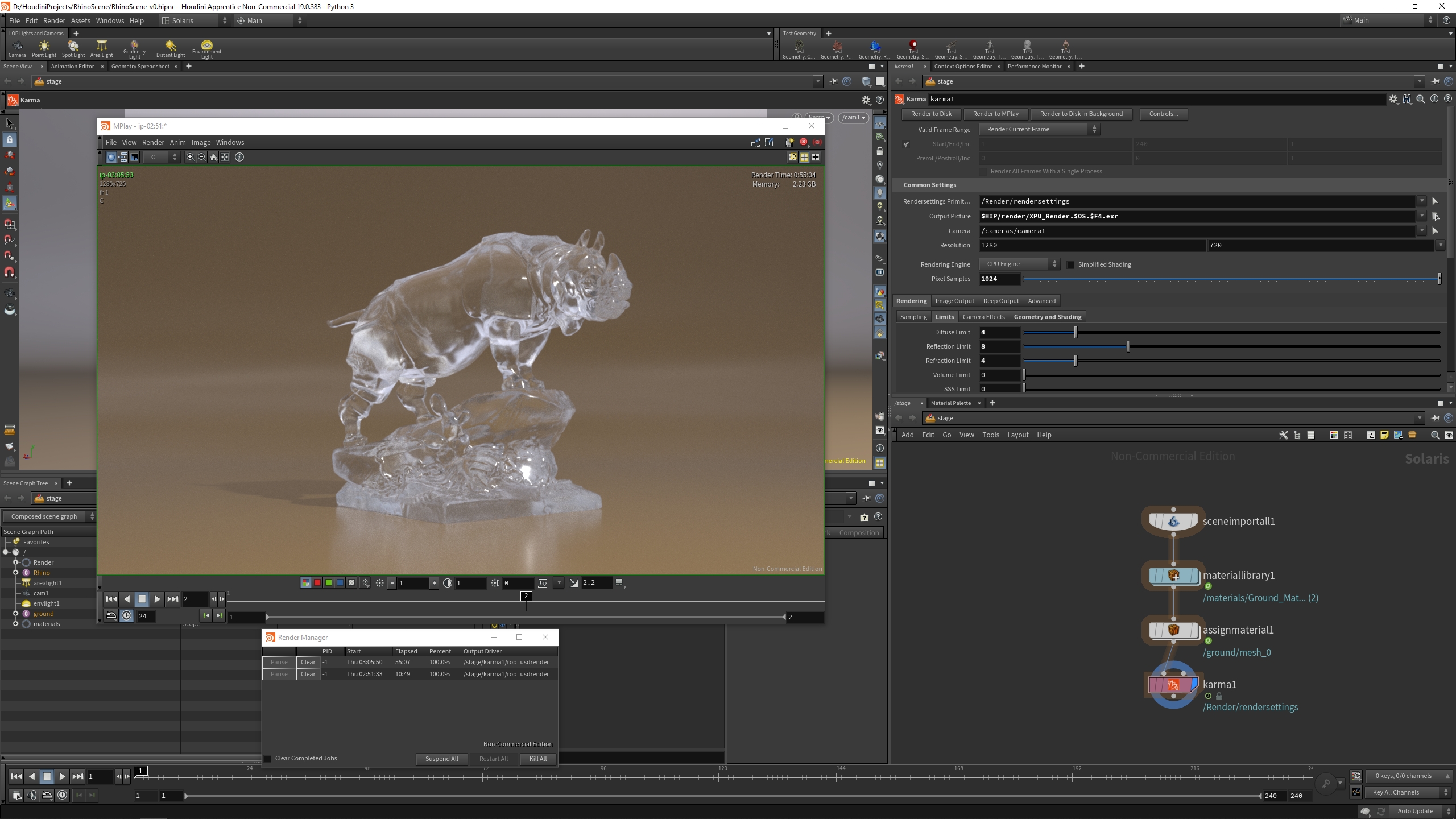

A second test, this time I build a simple Solaris scene with MaterialX shaders, I reduced the scan model to 280k polygons, this time I get no OptiX error, still rendered on an AMD 8-core CPU and a GTX 1650 GPU with 4 GB of VRAM, I used no denoise, I would love to know how fast this renders under XPU compared to CPU only, but with a decent CPU/GPU combo!
I rendered to mplay at 1280 X 720 pixels
XPU: 10:49
CPU: 55:07
You can download the full scene directory below:
Edited by GCharb - Oct. 28, 2021 04:59:38
