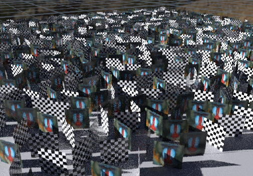

guilhermecasagrandi
At least in a crowd workflow, that's a problem because we don't have a "good" way to apply several different textures using a single shader. For now, I'll stick with vex for that.
You could use UDIMs?
So...
- arrange your textures in the UDIM tiled format
- have an integer primvar
- "add" the integer primvar to the input UV's in the shader graph (to match the UDIM textures on disk)
Another option is to again have an integer primvar, and use a switch node to select the correct texture result in the shader (although this would be more clunky, and also slower...)
Another option again might be to use the usdPrimVarReader and the usdUVTexture nodes. They allow for a procedurally-driven file string. I know they won't work in XPU (yet), but it might be an option for KarmaCPU.
Edited by brians - May 18, 2022 01:51:36

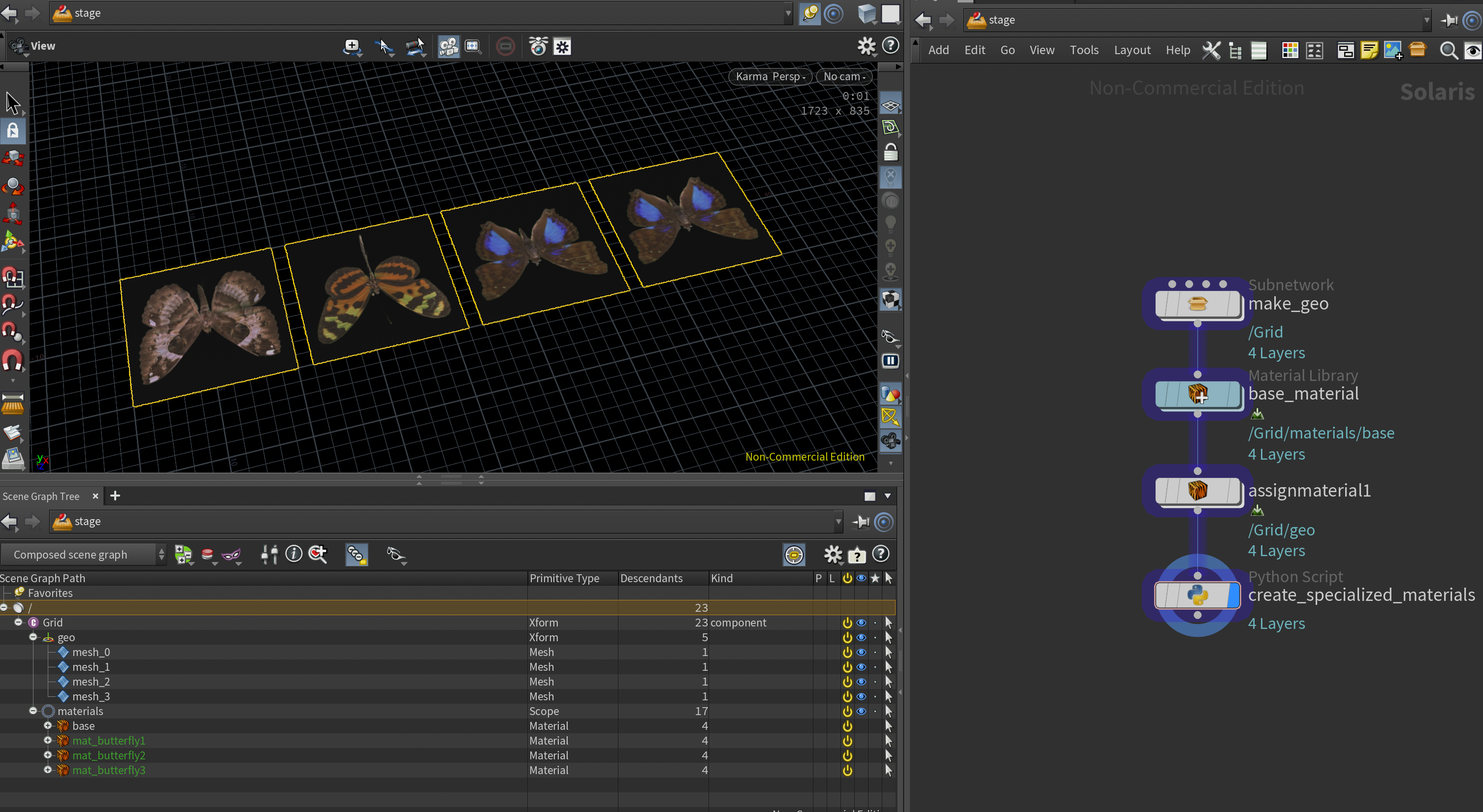

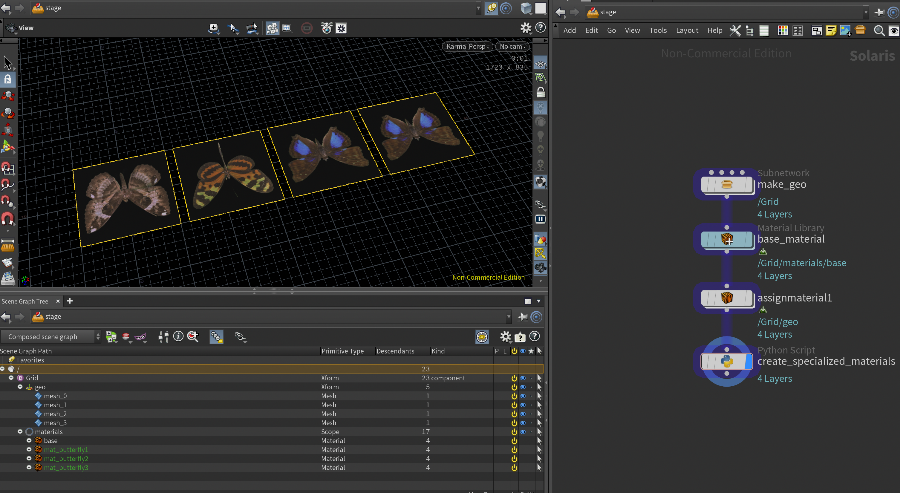

Apologies if this is more confusing than helpful, but from your description it sounds like you want something that builds out a bunch of materials based on some kind of texture attribute or primvar on each mesh in a model. Attached is my attempt at this, where (as a starting point) each mesh has a "diffuseTex" attribute pointing at a file and there's also a single "base" material. From there a python lop creates (and binds) a specialized material for each texture it finds on the meshes. Someone with better node powers than me could probably do this with nodes and avoid python.
So, due to the specializes arc the base material is still 'live' and any edits further down the line that need to target all the materials should continue to edit base. The 3rd and 4th meshes showing the same texture is deliberate in order to demonstrate that only one material is created.
Oh and I used usd preview surface stuff but materialx should work the same way.
