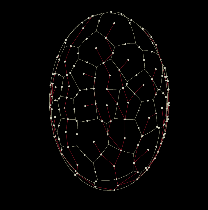

It's the idea for the skeleton

without looking at the file, this looks like Find Shortest Path on a Dual Mesh

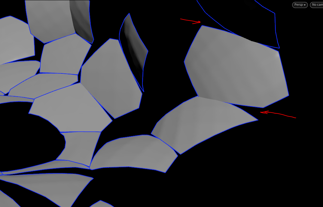

It's working pretty well. I start to get confused when dealing with large part, like with cluster. The disconnection on the pivot point along the coincident edge is getting too evident. I was expected this
Maybe in some case some vellum glue constraint on these part could give some interesting effect, after i don't see other idea
that's what im talking about there
