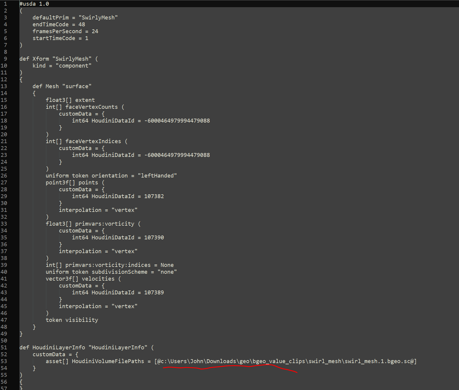

I've stumbled upon this thread and looked into the example. There's an issue with the geo path in the swirl_mesh_topology usd in that it is a full path. In the swirl_mesh.usda they are relative. Is this by design? I have to manually/post process this usda to have a relative path to work cross platform at the moment. Well, when I say 'work', it works OK but there will be problems if the metadata is required.

The usd rop has an output processor to convert paths to relative paths. They appear as absolute paths when working interactively since the output processor hasn't run yet.
