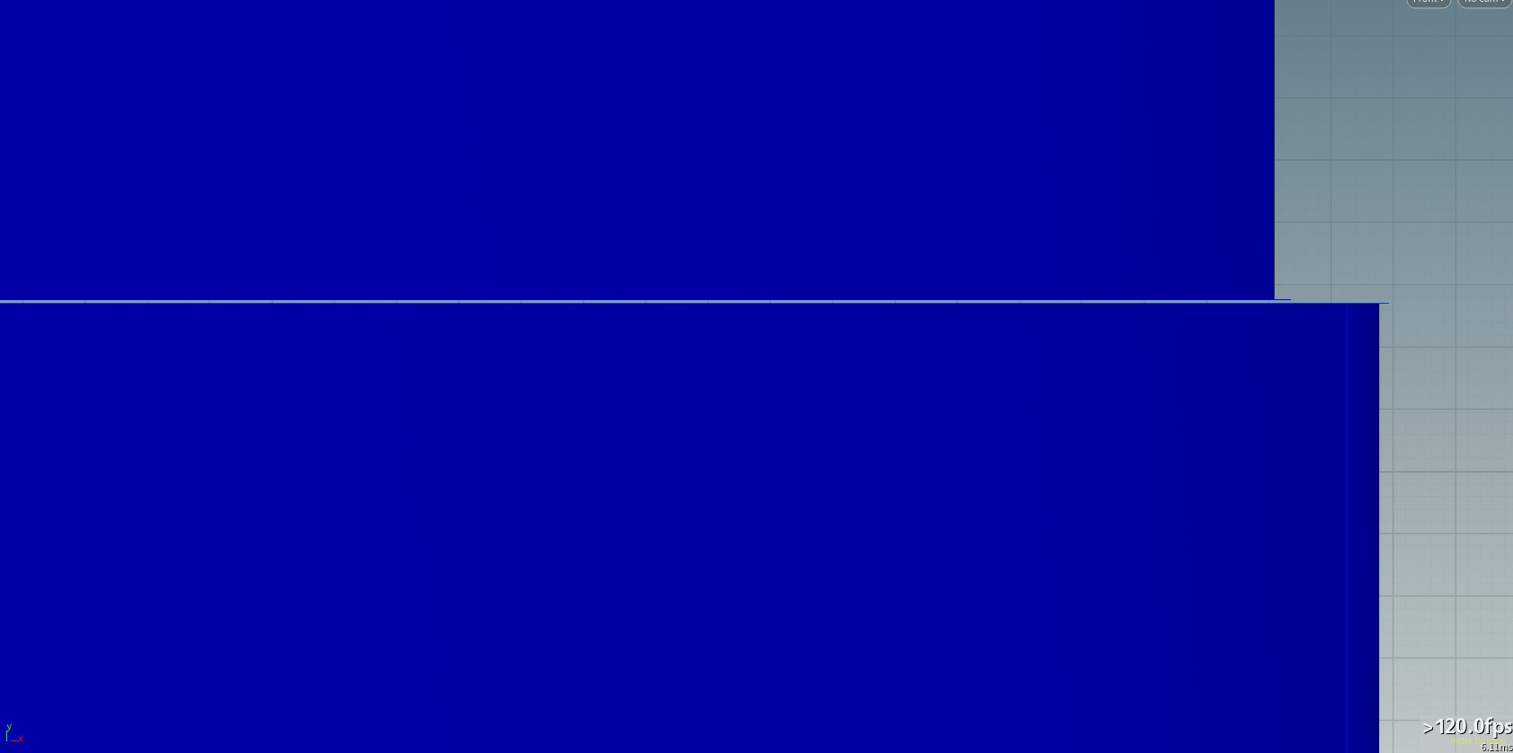

When I look at the coins very closely in orthographic view I can see there are spaces everywhere in between.
To me the gaps seem to be very small but distinct. I made them this small so the coins don't have to fall down on each other in the beginning of the simulation. With the collision representation objects it is the same. Am I missing some intersecting meshes here? Or can there be a "too close" to each other?
I might easyly increase the distances cause I created the whole cluster procedural. Do I have to choose a higher value here?
Make sure you always look at the bullet representation of the collider, not the geo going into the sim.

mrCatfishTo me the gaps seem to be very small but distinct. I made them this small so the coins don't have to fall down on each other in the beginning of the simulation. With the collision representation objects it is the same. Am I missing some intersecting meshes here? Or can there be a "too close" to each other?
Of course, that's what I meant writing collision representation objects.
I see gaps between the coins everywhere... have I actually overlooked any intersections?
