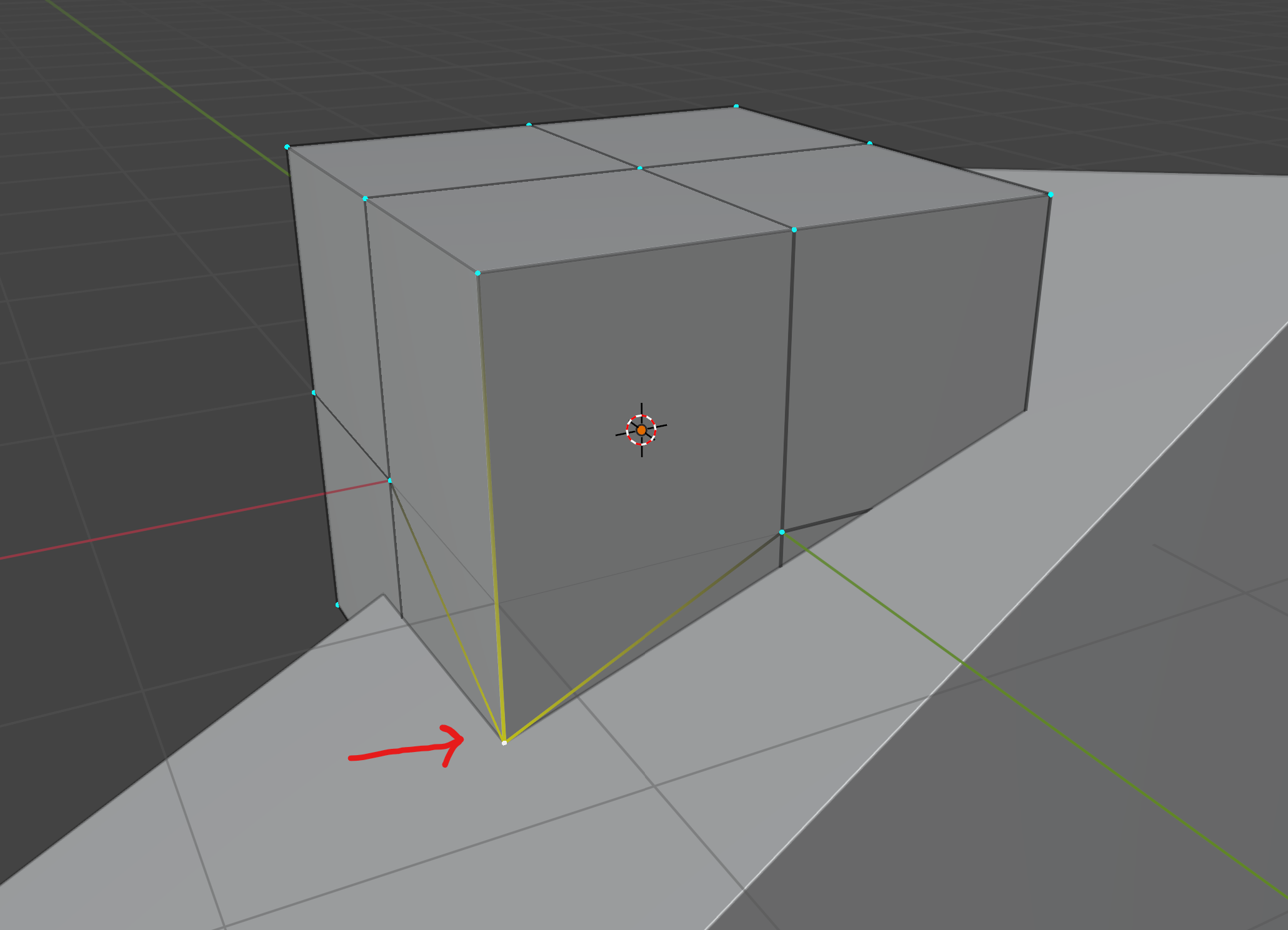

When modeling, I often have a need to align a point along its edge along another face as a screenshot. In the blender, this is done easily by enabling the snap face project and the point is aligned at the intersection of the shift axis and the face. In Houdini, the binding to the face works differently and the alignment goes to the point where the cursor points. If the face is parallel to two axes, it doesn't matter. But for an inclined face, this is almost equivalent to a non-working snap. Is it possible to solve this somehow ? I tried using C-plane as well, but I couldn't get anything useful. And how do you do such snapping ?

If I'm understanding correctly, I think boolean set to 'seam' mode would give you the reference points you need. You could then point snap to the generated points.
It has that kind of snapping, but it seems to be broken. Primitive snap is mostly non-functional.

Not being very familiar with Blender myself are you trying to do you something like this?

If only it was that easy : ) Your example doesn't, unfortunately, reflect the original posters request.
Download the file I offered above: boolean seam_snap.hiplc
Delete boolean1 and edit1.
Now see if you can snap point 3 to the intersection of the vertical edge it lies on with the inclined plane.
Please let us know how if you succeed : )

This is a very odd way of modelling since snapping generally requires "something" to snap too maintaining good topology (in this case the surface is a separate plane, even merged) being that this is **Houdini** if this method is really needed which would be rare then a quick wrangle to get an accurate intersection of the plane in the direction required to move the points in would do the job.
Not a fan of wrangles?....the "ray" node can be used too.

The ideal option would be alignment to the edge. This would solve all the problems with any polygons at once - straight, rotated, inclined, not in the plane, etc. Just choose an edge that fits and that's it. It's in the blender, but there is not and probably never will be in Houdini, because I don't see the slightest prerequisites for working with edges there. But there is already work with primitives and it needs to be improved a little and it seems to me already real !
if someone does not understand the problem, here is an example of a simple test, I sent it to tech support. I was making a complex model of many objects and I had to adjust parts of objects closely a lot, just by moving the points along the axes and resting on the "middle" of the target polygon, where it has no points to anchor. It's easy to do in a blender through binding to faces or edges, but when I tried to go the same way in houdini - it doesn't work. And the workarounds are just incredibly tedious and make it useless, you don't move 1 or 2 points. There are many of them at different times. This upsets me, I like the procedurality of being able to come back and correct mistakes or consider options. But snapping upsets.

Frankly I agree. Can the above scenario be solved? Yes, of course. Pretty much any geometry manipulation can be done in H : )
Should it be an easy one drag direct-edit-with-snap operation? Yes it should!
I've submitted various snapping RFE's (Request for Enhancement) myself and all I can do is suggest you do the same.
I've no idea what workarounds support has suggested for the above, but I've attached one of my own : )
