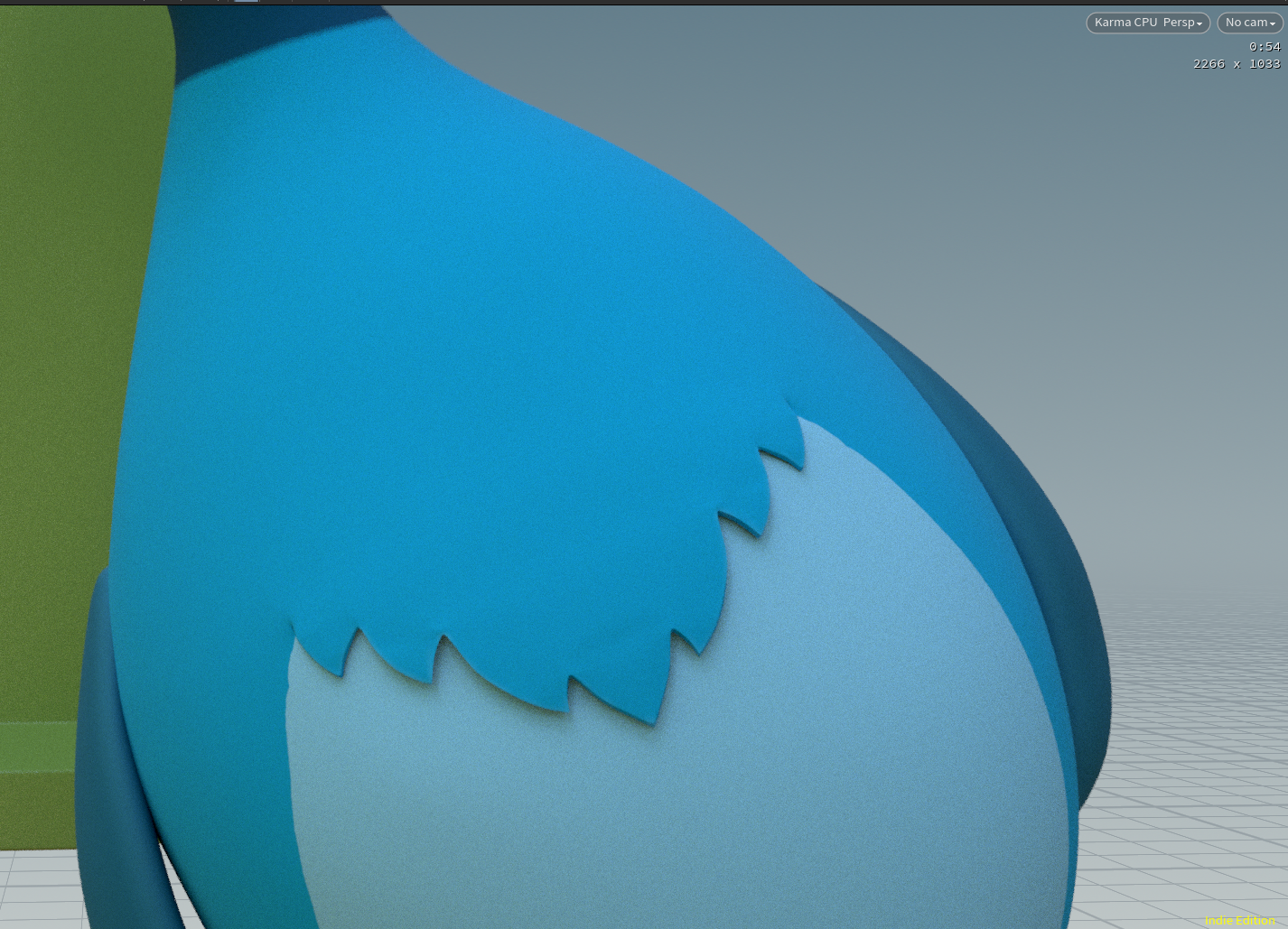

An update on issue about those nasty splotchy parts. Seems like when I use couple specific HDRs for lightning from dome it creates those. I used other HDRs and it is less visible or visible from some angles. And with dome only no HDR or physical sky it looked completely fine. Looking more into it as well. Still works fine in CPU

True topology isn't the best but it shows up fine in Maya with smoothing, also Redshift with it's tessellation on works just fine.
If I import alembic and then subdivide mesh that also works fine.
So I'm wondering if there is some step I'm missing to export animated mesh from maya to USD and then loading in Houdini for rendering?
I know that USD is not really just a simple geo cache like alembic but in this case I'm using it like that as it works much faster compared to alembic and looking to expand USD usage but for now trying to transfer animated character mesh from Maya to Houdini to render in Karma XPU.
Am I missing some export / import steps maybe?
I've paste link to that same usd if someone care to give it a try, I'm still finding my way around Houdini so it could be simply some beginners mistake in import.
Appreciate any help!

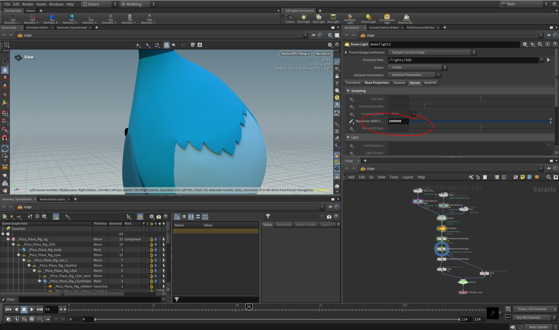

Hi guys
We've isolated the issue to a bug with XPU dome lights.
Karma XPU performs mipmapping (when combined with sampling produces the issue), whereas Karma CPU does not perform mipmapping.
So nothing wrong with the geometry
In short, we're still working on it.
But in the meantime you can work around the issue by setting the DomeLight setting "Maximum HDRI Size" to the size of your HDRI (eg 8k or whatever). And actually, you can just set it to something massive (eg 100000) and XPU will clamp it accordingly. This will solve the problem in the short term.
Thanks for your patience

I have committed a fix for this in 20.0.563
In short, we have disabled mipmapping for textured light sources (ie dome lights and textured rectangle lights) in XPU. This means the artifacts will disappear, but lighting will also look slightly darker after this change. But it does at least match Karma CPU more closely.
To get lighting to match 100% what it should be, setting the "Maximum HDRI Size" to the size of the HDRI (or just 100000) is the recommended approach. This will work for both KarmaCPU and KarmaXPU.
We'll be looking to fix this darkening issue in a later version of Karma.
Thanks for your help + patience on this issue.
