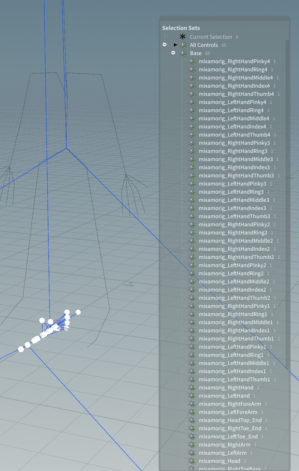

I am trying to understand how to do basic rigging in APEX by following the Max Rose Tutorials in You tube. When I connect the packfolder to the FKTransform Autorig component the skeleton goes haywire as shown by the blue lines in the image. The light grey lines represent the source skeleton which is a Mixamo one. I'd be grateful for any assistance anyone can offer/:

Yea you need to use Attribute String Edit SOP on the capture pose.
Checked Points
'name' in the field
Then go to the Editor tab
From: mixamorig:
To:
Leave "To:" blank

It needs to be removed for all THREE of the FBX Character Import SOP's outputs. For the skin geomtry, they're in the points boneCapture attribute. For the skeletons, they're in the point name attribute. After you do this, test with a Joint Deform SOP and rig pose to make sure everything is still working before doing the APEX work.
