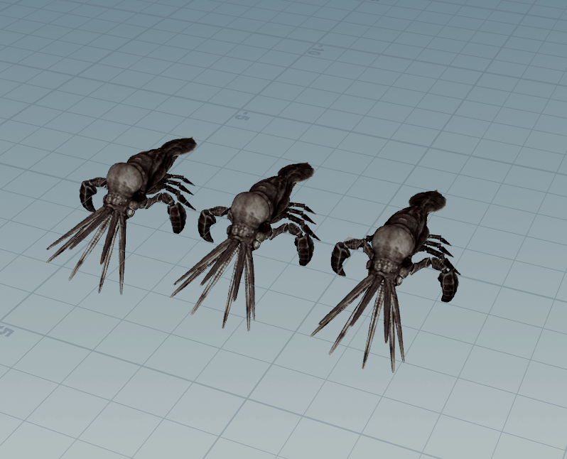

I'm getting a bit concerned how Sidefx layout editing tool Solaris is the basically same since the last 3 major versions, which is mostly not very good. Id really like to use this tool but i just don't get whats going on.
Seems for precise layout editing you have two options, the stage manager or edit node. In edit node you cant delete or duplicate.
I open houdini and put down a single sphere and stage manager node. First it doesn't let me select my object because i'm not in the select mode. Why is this? Why can't I select another object in Move mode? You could do this in SOP edit. It was fine. With the edit node in lops you can select objects while in move/rotate/scale mode but only one! Why ? If i want to go to select mode and come back do my transform. In stage manager im not even able to transform multiple objects. It does highlight two object but pivot stays at one and only one object is getting transformed.
It really does need a lot to make layout editing effective, i need to be able to copy, delete objects, select and transform multiple them efficiently, would be nice to able to align an object to another and an easy way to replace my inputs but keep my layout. Is there a way not to use the snap menu when you press x but instead have the snap active while the button is pressed? Why is physics based transforms are not available in stage manager, only in the edit node?
There is also the layout tool, where plenty of function just doesn't work in the default point instancer mode, you have to change to something else or you cant copy things for example even though there is zero indication of this. There is a nice tooltip telling you have to press Z to copy and somehow be aware this tool doesn't work at all in the default mode. But ok lets try with instancable references. I made a gif about how does that looks like. Also not sure how i can easily put assets to assetgallery besides componentbuilder, and how can i replace objects easily after they been layed out.
Do i miss something here? How do you guys create your layouts? Does sidefx planning to to streamline ever this experience, or we just going to get new brushes in every release?

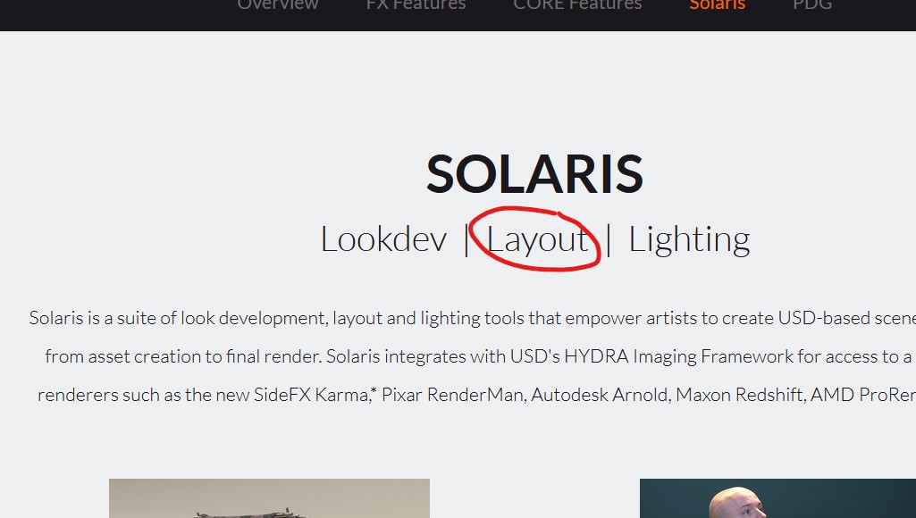

I thought when Solaris first got released they focusing on having the framework ready to allow companies develop for it, and will work out the chunkiness in time, but seeing how stupid bugs that you would expect from an alpha software are still in it i really have no idea whats going on.
Would be nice if someone from Sidefx could shed some light on whats going on, as so far this is false advertising.

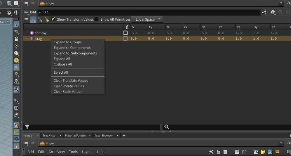

While in edit mode you are able to see the transforms of you're objects. There is a global reset on ui, but if you want to reset specific channels, those are in the right click menus. No way to select transformations nor copy/paste them.
While in stagemanager this functionality is completely missing, you supposed to get into and find your transforms on numbered tabs....

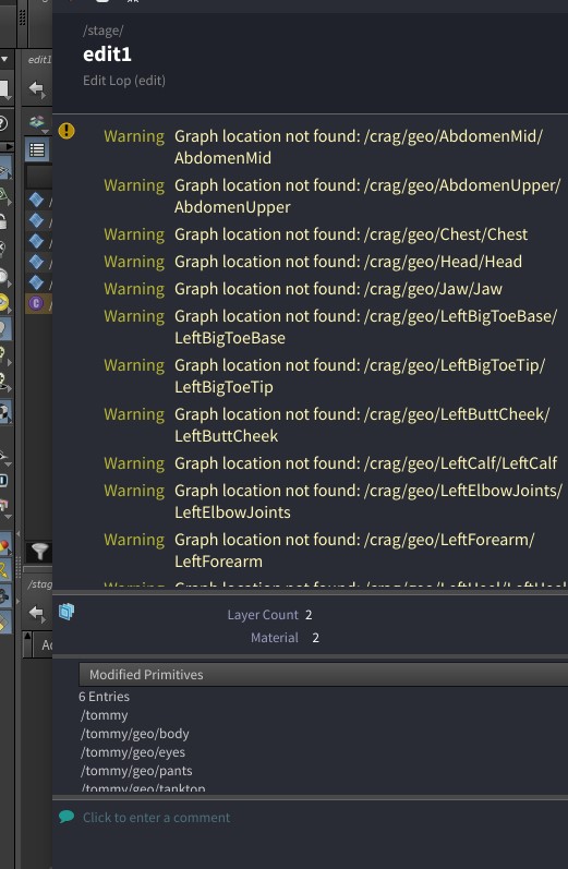

If you delete an input of the edit its going to error until the end of the time, only way to stop it to find the missing geo or anything with same name, add back, clear selected edits, and remove it afterwards.
There should be a button to remove not-connected geometry, and have a mode where i can see every transforms, even the not connected ones too, maybe have them greyed out
