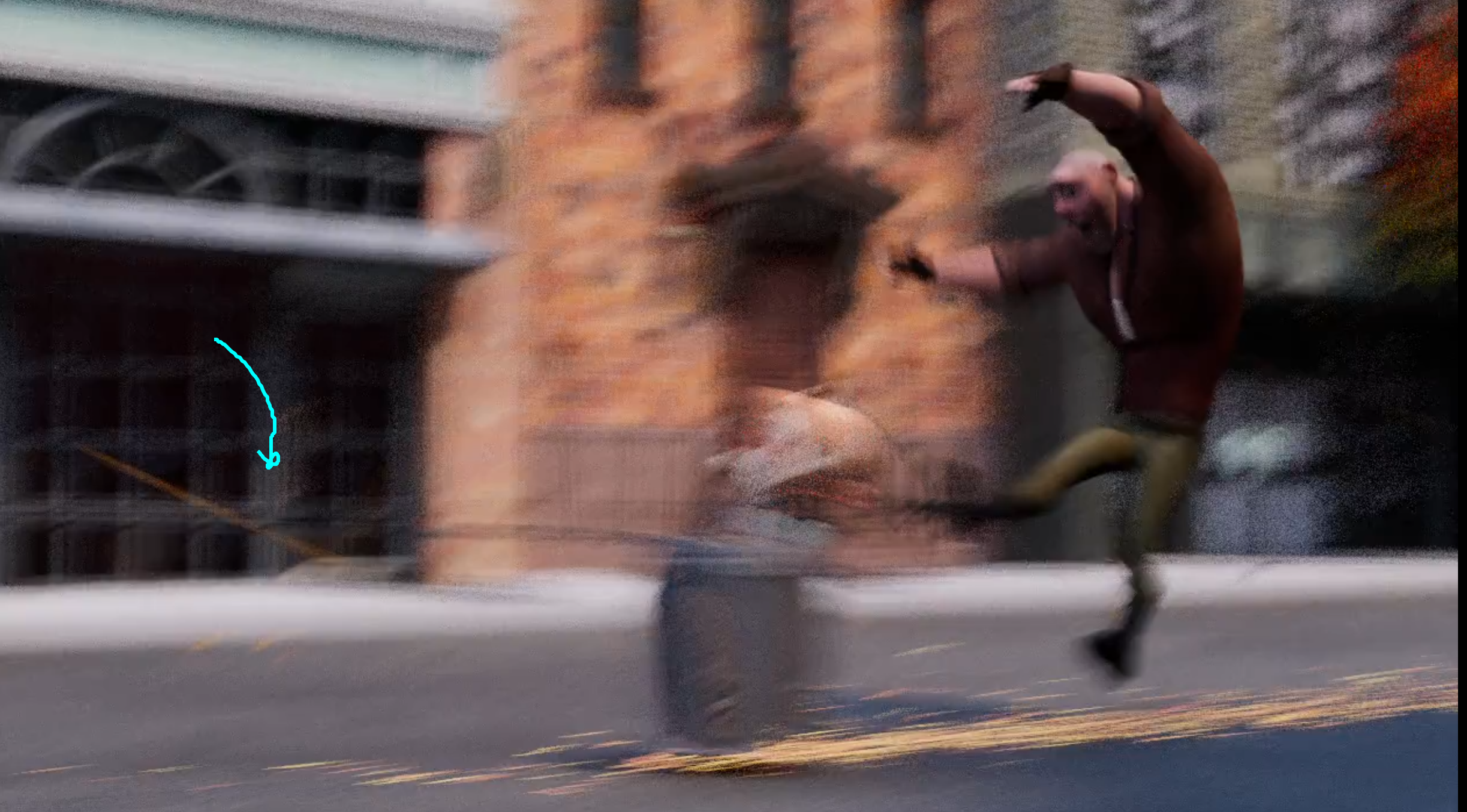

I'm working on a film that has a lot of leaves on the ground that get blown around in a kind of twirly motion.
The animated leaves are pulled in from a USD. When we enable motion blur, quick moving leaves are streaked out, like the one pointed to here:
The streaking motion blur doesn't properly express the correct motion of the leaves, which is more circular. How would I handle this in Solaris? Do I need to somehow export the animated leaves with substeps? If so, how? (And after doing so, I'm assuming I'd also need to increase the cache substeps?)
Thanks!

The shortest answer I'd give is: yes, more time samples.
As for the how & where ... it depends a bit on how you're authoring the animation for the leaves.
Some of the LOPs have a "Frame Range / Subframes" section at the top of the parm dialog where you can directly author subframe data just for the specific work being done by that LOP. The Cache LOP is a broader brush for time sample generation otherwise.

if your leaves animation is a geometry cache with velocities on points, you can potentially include accelerations and use acceleration MB to get some for of curved MB without any timesamples
if you are relying on deformation MB then you would have to have proper deformation timesamples cached, either from sim or at least interpolated using Cubic or Subd retime mode and stored as timesamples on points in LOPs
if however they are animated transforms and using transform MB then just more proper xform timesamples would suffice

So, if I have a pop sim that I'm instancing some geo on and then I SOP import that into Solaris, I'm looking for the ability to USD Rop it out with the needed substeps. The SOP context had all the substeps I need, but I'm not sure how to put them into the USD.
Would it be by lowering this `inc` value to something below 1? I'm going to try it and see if it does what I need.
Thanks again!
If using SOP Import then I'd consider a setup like the attached hip where you split the SOP import off to the side in its own branch, specifically Cache that branch with a bunch of substeps, and then Merge those time samples into the rest of your scene.

Hey, this fixed it! Thanks so much!
