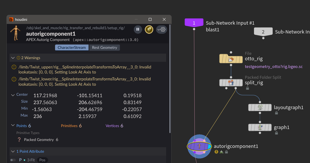

Diving into '/rig_transfer_and_rebuild/setup_rig', the autorigcomponent throws an error:
