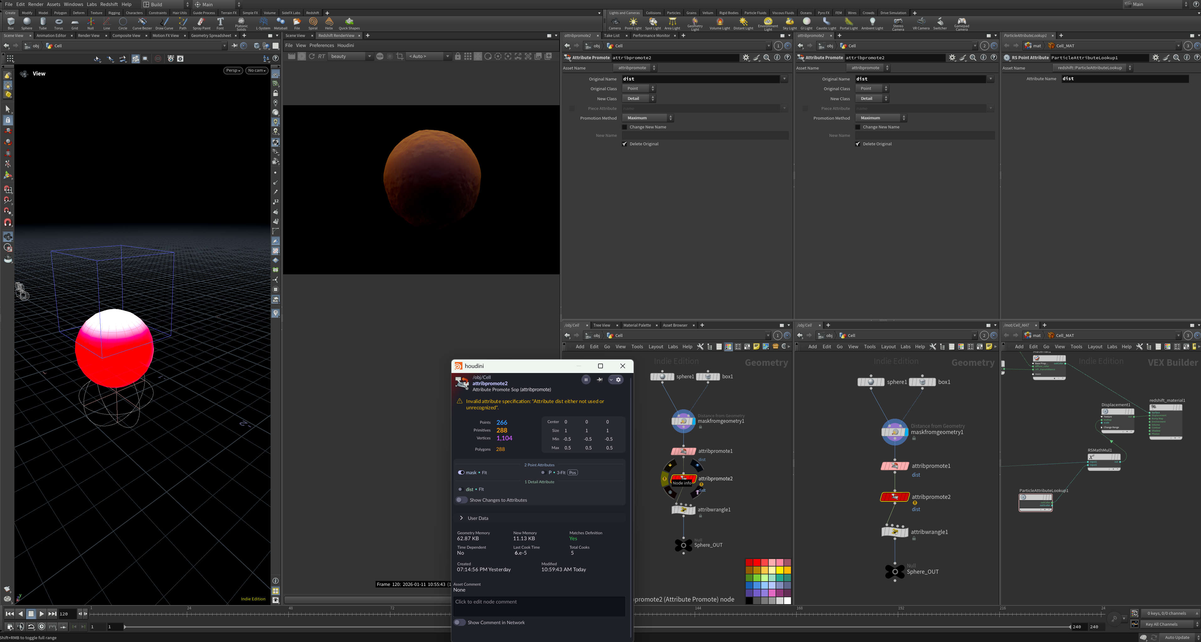

I have set up a simple sphere, which has been textured and displaced.
I do not want the whole sphere to be affected, so I added a maskfromgeometry node, but this does not affect the displacement. See image.
Do I have the correct node? Have I completely misunderstood how to use masking? Any help appreciated.

You need to normalize the dist attribute and multiply that with the displacement amount inside the shader for it to take affect. The shader won't automatically pick that up.

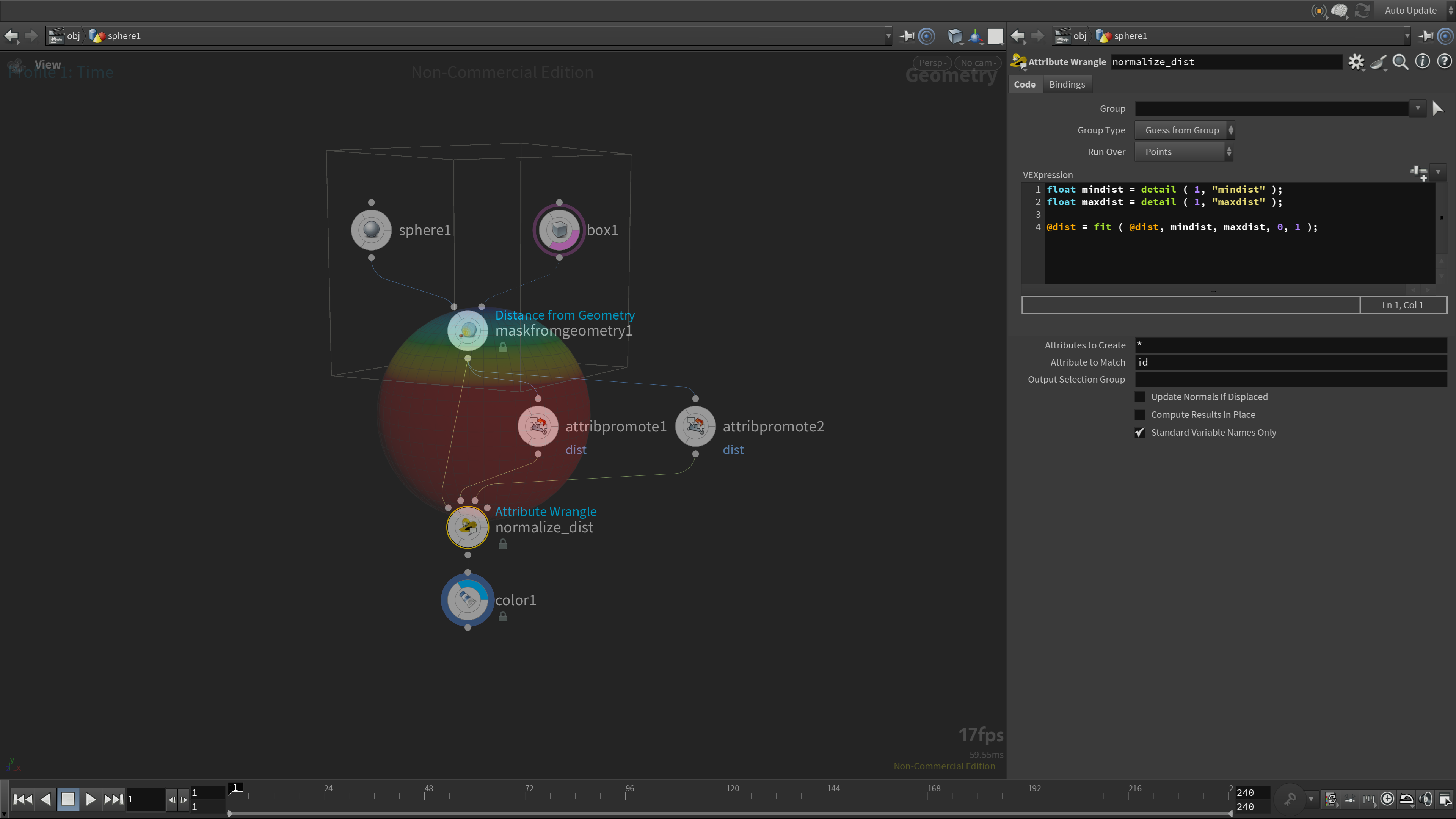

You need to normalize the dist attribute and multiply that with the displacement amount inside the shader for it to take effect. The shader won't automatically pick that up.
Thanks so much for the advice.
You will see from the attached image that I still have a long way to go to know a 10th about Houdini. I have attempted to follow what I think you mean, but as you can see, A, it has not worked, and b, clearly I have not understood fully how to do what you suggested.
I used an Attribute Promote for l min and max of @dist.
Then used an Attribute Wrangle to remap @dist to 0–1:
In the RS Material Builder, I used an RS Point Attribute node connected to an RS Math(multiply) to scale displacement.
Happy to upload the file if it helps. Thanks for your patience!!
5316 posts
Joined: 2月 2012
RS Point Attribute should use the attribute name dist, not float.
Also promotion and the fit VEX code needs to come after the Distance from Geometry node because the attribute is created there. You can't modify the distance values before they are created.
9725 posts
Joined: 7月 2007
Based on your first screenshot you already have remapped f@mask attribute, no need to deal with dist
So you can directly bind "mask" attribute in the shader
Ok. Updated as you suggested but still getting an error on the maximum promotion, which I guess is why it still does not render correctly.

You get that warning because you need to turn off Delete Original in the first Attribute Promote:

animatrix_
Thanks, that removes the promote error.
tamte
tamte's method works and is simple, but I would still like to understand and resolve your method.
From the image, you can see it is still not displacing correctly. In fact, if I remove the Attribwrangle, it makes no difference to the render. Could my VExpression not be valid?

5316 posts
Joined: 2月 2012
Yes you can't access detail attributes like that in a Point Wrangle. You need to use the detail function:
detail ( 0, "dist" );
It's also a good practice to rename these so you don't have 3 attributes with the same name, where the second detail attribute will overwrite the first one.
Or you can branch them out and connect to different inputs of the Wrangle SOP and access them using the second and third input:
But for your displacement, mask is the attribute you need like tamte said.

animatrix_
Many thanks. Works perfectly.
