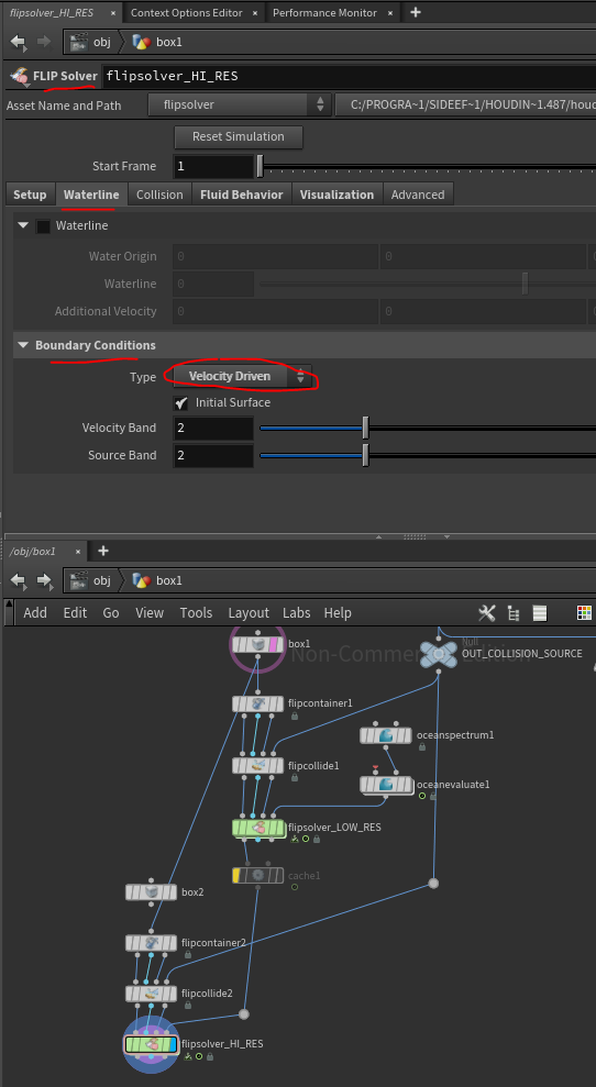

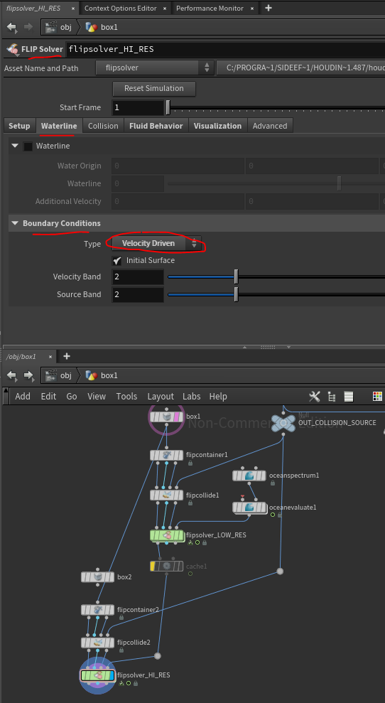

- Hamilton Meathouse
- 228 posts
- Joined: 11月 2013
- オフライン
tamte
you can also have a look at newer workflows which are simpler to use
https://www.sidefx.com/docs/houdini/fluid/sopupressing.html [www.sidefx.com]
Just a note on this tutorial, in order for upres to work and maintain the general shape of the low res sim, you need to change the Boundary Condition in the Hi-Res solver to 'Velocity Driven' - see attached pic.
