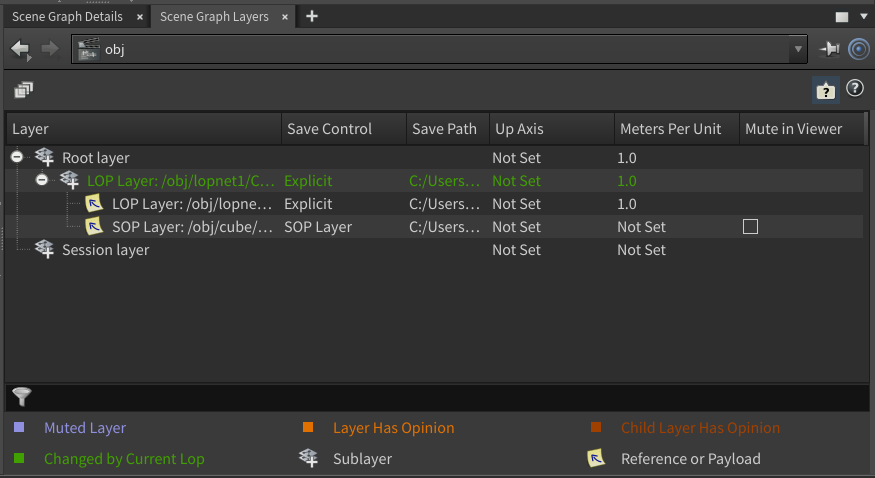

Joined: 8月 2021
My Scene Graph Layers pane has a question mark icon that brings up the color legend. I don't see it in the above screen shots, so maybe it's a new feature (I'm on 19.0.478 with the default Solaris desktop). I've attached a shot of what I'm seeing.
