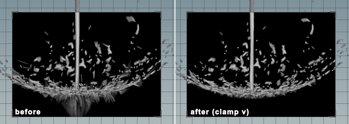

Hello,
I have some difficulty with my motion blur which largely exceeds my real motion (cf. screenhot).
I would like to know if it's a common problem and how you think it can be resolved.
Thank you.

241 posts
Joined: Oct. 2015
Thank you,
I clamp my velocity in an attribute VOP from -40 to 40 and, even if it's not perfect, it considerably reduce this overflow (cf. screenshot).

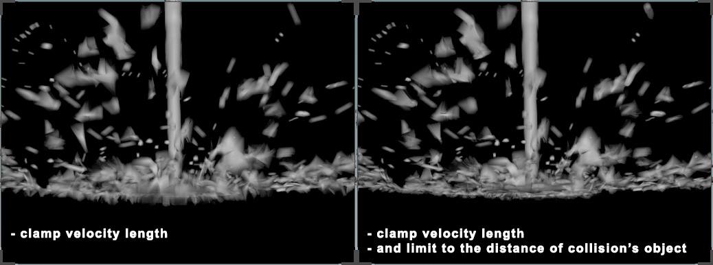

241 posts
Joined: Oct. 2015
Just to conclude,
I need to clamp my velocity vector length instead of clamp individually my velocity vector components (x, y, z) individually like I do in the attribute VOP screenshot of my last post ops: .
In order to not change velocity direction.
To polish more :idea: I compute the distance from each liquid point to the collision object (use the velocity for direction) and determine the lower velocity length limit (cf. screenshot).
