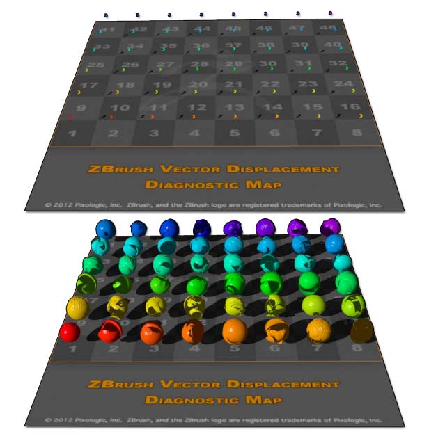

I haven't spent much time with it yet, but newly released ZBrush 4R8 apparently offers some new vector displacement functionality. I'm sure you've taken a look already, but it will be interesting to see if anything has gotten easier from that end.
http://docs.pixologic.com/user-guide/3d-modeling/exporting-your-model/vector-displacement-maps/ [docs.pixologic.com]
Bear in mind that vector displacement maps are not yet standardized within the industry. Each rendering engine approaches them in a different way, and can execute the various render steps in a different order. As a result, a map that works perfectly in one rendering engine will likely produce an inaccurate render in other engines. You will need to experiment to find the correct combination of color order and direction for your pipeline.

Yes, new functionality regarding VD has been added, but it's related to working inside Zb, the export process of VDs seems to be the same.
