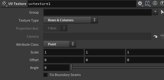

You can texture the curves in Rows & Columns mode, then use primuv() [www.sidefx.com] to lookup the interpolated values based on UVs. This example uses VOPs, but the same can be achieved with a wrangle.
Hope that helps!
(edit: didn't see that link in the last post, which is also suggesting primuv!)
Hope that helps!

Hey! Thanks for all the ideas and examples.
In terms of the original question: How is upsample intended to work, I think @galagast probably has the real answer, in that it doesn't work for my intended target, polylines.
@goldleaf, your example is very cool but I don't think it gets at the core of what I'm trying to solve: I have non-evenly-sampled polylines (different length segments between points) and want to get points at set distances along the curve from a given point along the curve.
Basically interpolating points but by distance instead of the non-evenly distributed U coordinates that most (or all) of Houdini's tools want to work with.
I've tried setting the u values to be distance-based, but that seems impossible on polylines (discovering along the way the distinct difference between parametric ‘implicit’ u-coordinate and u, in terms of texturing, coordinate).
So I thought, if upsample() lets me use another attribute, besides the non-editable U-coordinate, I can pump it with my correctly-valued attribute (e.g. “distanceAlong” or something like that) and get points at specified distances from any reference point. But, looks like that won't work in this case.
