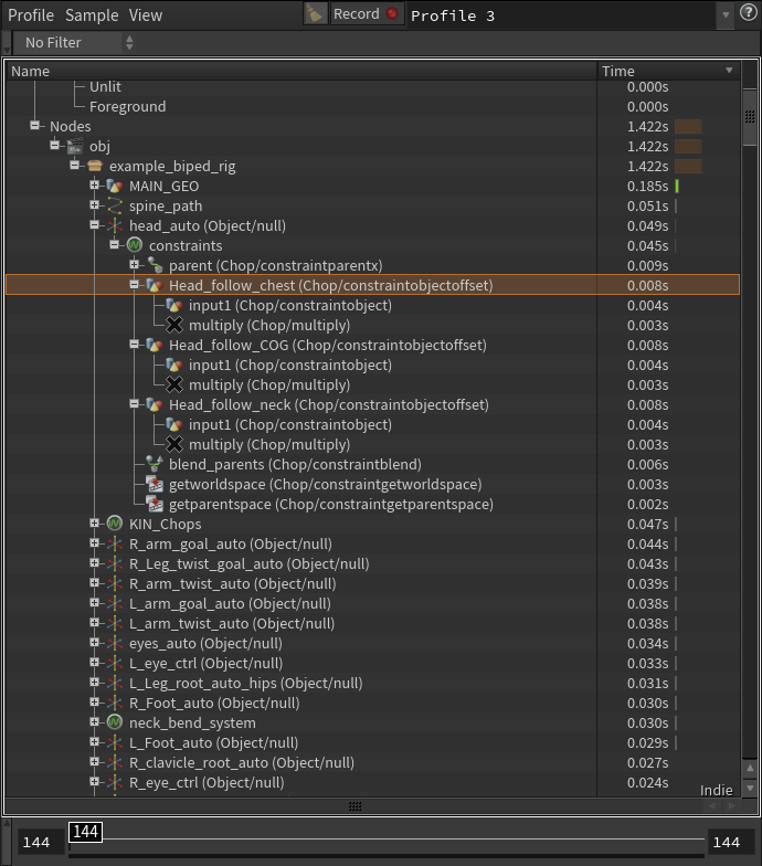

A back of the envelope 2x performance diff is not the whole story. Let's take a more concrete look at the performance numbers. Please note this is on an older box with a 750ti. My home workstation has run into some hardware issues so I'm using my server instead. On a newer machine, I got around ~600ms of viewport evaluation for 2000ms of node evaluation.
The top item on that list, MAIN_GEO, is where the deform SOP is evaluated. The release notes of Houdini 17 claim improved rig performance by speeding up the bone deformer and viewport display. I haven't ported this rig back to 16.5 to do a serious comparison, but that result seems reasonably fast to me. The deformer takes up a little over 1/10 of the whole node graph evaluation. Sure I should chop up the rig and parent it to the bones for a speed boost, but even in an optimistic scenario where the geometry has no cost, an extra 15% FPS isn't going to get me to a smooth frame rate. Also, I don't need to go through that inconvenience to achieve smooth interaction in Maya! (I wonder: is the deform computed on the GPU? What about viewport subdiv?)
After that, the performance is attributed to long list of CHOPs for space switching, IK, and other constraints. It should come as no surprise that CHOPs and constraints are as costly in Houdini as Maya's constraint nodes, which are famous performance killers, since the two systems do nearly the same thing under the hood. However there are some additional performance surprises that aren't shown. When rigging the fingers, Michael Goldfarb uses parent constraints with an offset to make the the finger bones track the controllers. There's no need to store an offset, and evaluating 38 additional offset nodes + parent nodes causes a serious performance hit, so I set the finger joints to simply track the controllers in world space. Even after this optimization the fingers remain ~10-20% of the evaluation cost.
Another CHOP performance pain point: Constraint Blend nodes don't seem to correctly terminate execution of the node graph on upstream nodes with weight zero. Houdini seems to spend time evaluating nodes with zero weights on a Constraint Blend. I've attached a second performance log [imgur.com] with more details on the internal breakdown of these Parent Blend constraints. Hopefully this is just a bug.
After that, the performance monitor is simply a long list of nodes with no obvious culprits. But there's another important piece of data: the task manager. Probably the most striking thing I discovered is that Houdini seems to be limited to a single core while Maya uses several. That is, Houdini tops out at 8% on my 8700k, which is 1/12 threads, and 3% on the Xeon box I'm using at the moment. Maya is of course engineered around fast custom rig evaluation, [twitter.com] but as far as I can tell, there's no way to evaluate a rig in parallel in Houdini at all. Hou is a performance beast inside of SOPs, DOPs and VEX, but up at the OBJ level it carefully tiptoes through the graph on a single core. If that is the case, it's by far the most fundamental limitation of Houdini's rigging capabilities. Even a mindblowing pose tool and the best autorigger on the market won't make Houdini competitive for character animation if the performance stays as slow as I'm experiencing.
That fact is what causes me the most hesitation in investing more time in Houdini rigging. Sure I could implement those Python callbacks and chop the model up to get a usable rig for our gray lambert man. But what happens when the rig requires more complexity? How about rigged toes, doubling the performance cost of the fingers? What about wings, horns and a tail? What about a complex facial rig? What about props, or parenting an entire rig to another? What about componentized parts?

Cool testing… some workarounds to double the interactive performance so that COG performance goes from ~20fps to ~50fps and upper limb goes from ~40fps to ~100fps.
  1. Turn off bones - use the sunglass icon- viewport right
  2. Turn off nulls* - sunglass icon.
  3. Make the viewport full screen - this removes the parm updates
Linux, H17.0.352, Ryzen 1700 , 1080ti
*Just be sure to make the handles persistent on the nulls before you turn them off. Also the performance monitor also slows things down.
PS H17 also finally has the bug fix on the bones so they can snap be snapped too.
EDIT:
digging further; the bug fix in H17 for snapping bones turned off the HOUDINI_OGL_FAST_BONES environment variable, which when turned back on sped up the bones. The Nulls don't have the same speed up, so that's a bug.
When enabled, nulls and bones rendering is done by accumulating all
the objects and issuing one instanced drawing call.
The speed ups are:
20fps - default
30fps - fast bones env var or hiding the bones
40fps - hiding the nulls or setting them to axis
50fps - closing the parameter and, sometimes, network pane.
Edited by anon_user_37409885 - Oct. 14, 2018 17:53:18
