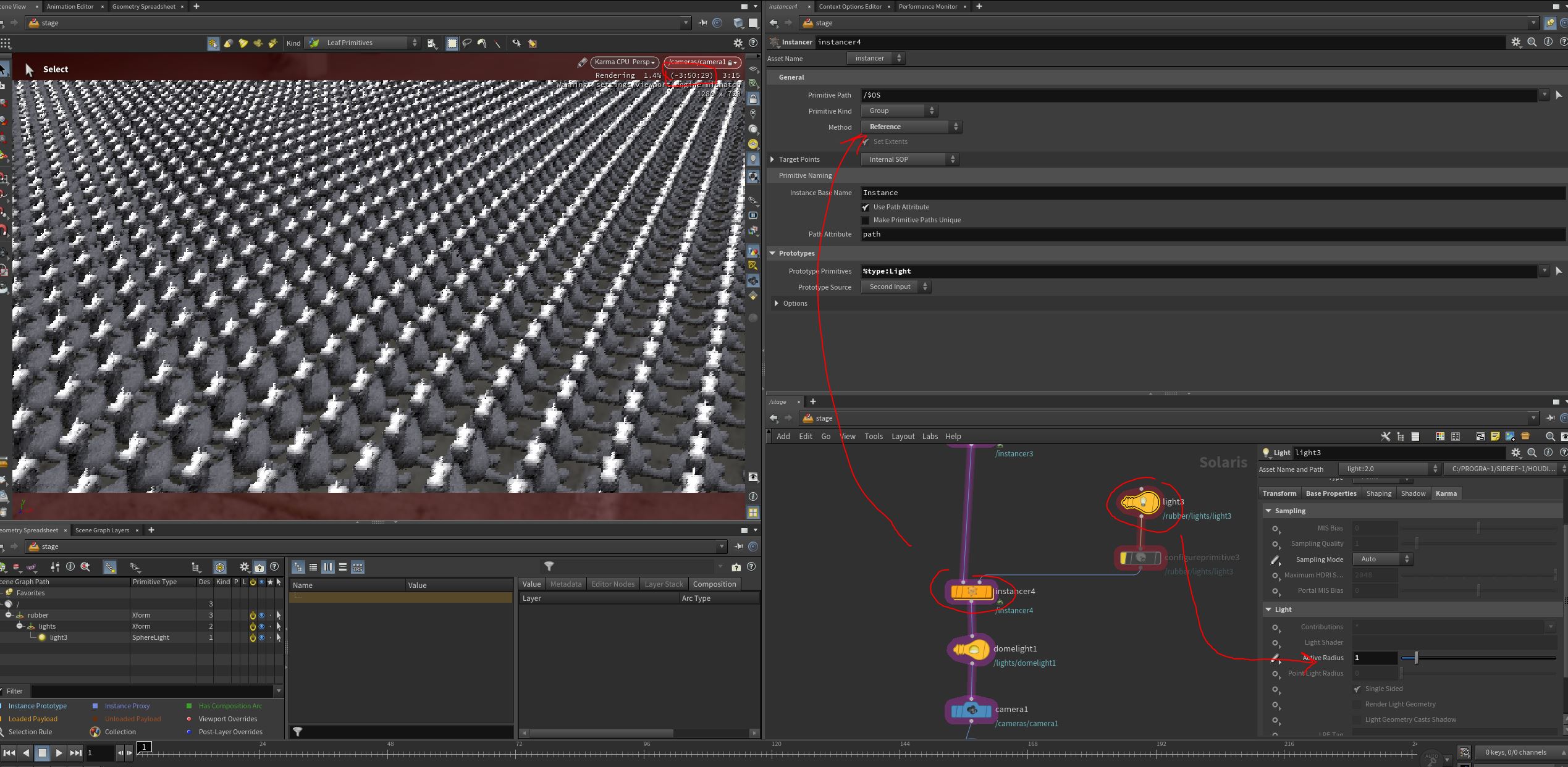

@robp_sidefx - what part is not supported by Karma?
Light Referencing (which in reality is just a copy of a USD Prim), has worked in Karma since Day 1 I believe.
I assume this new USD feature is something beyond that?....
Edited by TwinSnakes007 - Feb. 20, 2024 08:10:45
USD Light Instance.png (1.8 MB)

635 posts
TwinSnakes007
Light Instancing (which in reality is just a copy of a USD Prim), has worked in Karma since Day 1 I believe.
Yes, copying/referencing the prim works. But if you switch the "Method" on that node to "Point Instancer" the lights don't instance. Historically this wasn't supported in Hydra at all but, with 23.08, it is (but the render delegate still needs to do some work to support this).
