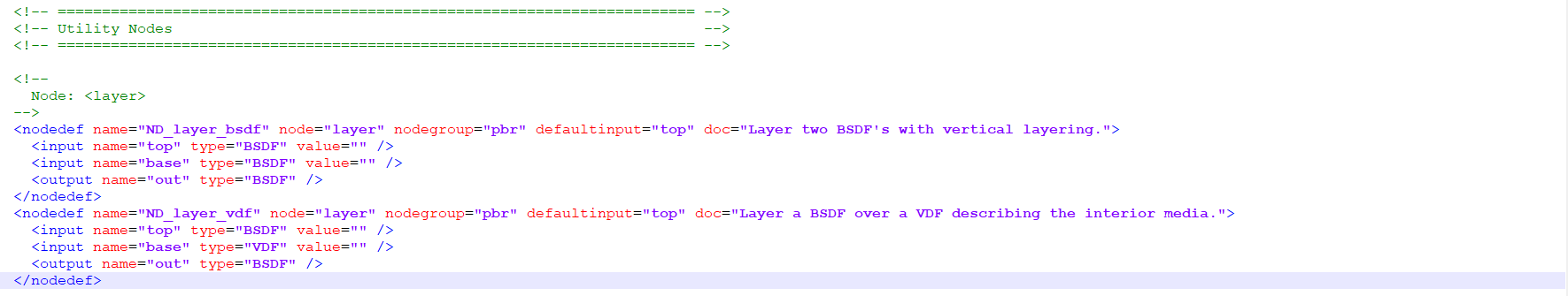

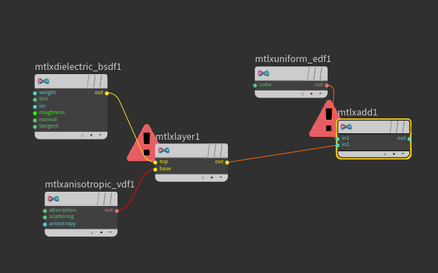

I have recently been creating the Lama node definitions inside of Solaris using the MaterialX BSDFs and the Node definitions from MaterialX and I noticed that the mtlxlayer node doesn't have the functionality described by MaterialX
in the pbr spec it states:
If transmission scattering is enabled the node may be layered over a VDF describing the surface interior to handle absorption and scattering inside the medium, useful for colored glass, turbid water, etc.
The mtlxlayer (layer) should support the layering of vdf and bsdf with an output result of bsdf.
It seems this is currently not supported and I was wondering if this will be possible in the future, otherwise a true implementation of the lama nodes defined by MaterialX is not possible.

The MaterialX VOP nodes in Houdini directly reflect the MaterialX shader definitions in .mtlx filed.
So, even thought the .pdf document stipulates that the ND_dielectric_bsdf node's parameters can be set up to "handle absorption and scattering inside the medium", the actual definition of the ND_layer_bsdf in the pbrlib/pbrlib_def.mtlx specifes only 'BSDF' as the input types. Ie, the layer shader does not have a version that would accept VDB as an input.
So basically, it's the MaterialX 'layer' shader node shortcoming.

Hi Rafal,
Thanks for the speedy answer.
I'm assuming this is due to Houdini not using the most up to date version of MaterialX?
When I take a look at the pbrlib_def.mtlx there is a ND for ND_layer_vdf which takes a VDF base and a BSDF top.
Since the Lama definitions were only put in since 1.38.2 I'm also assuming this definition was not around in the version implemented into Houdini which im guessing is just using 1.38.0?
If so this makes sense and i hope an update for this can be released at some point in the future.
Also us it possible to make our own MaterialX VOP nodes based on the ND's for the time being or is this not available for public access? and are there any resources available for writing shaders for karma?
Thanks for your help,
Rich

HypershaderYes. I think Houdini uses 1.38.1. It will be updated eventually to the newer one.
HypershaderYes, you can add new shader VOP HDAs, or you can copy and extend an original HDA.
https://www.sidefx.com/docs/houdini/solaris/shader_framework.html#creating-a-new-shader-hda [www.sidefx.com]

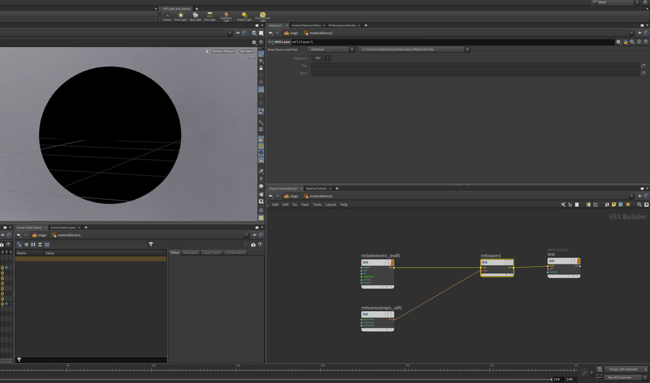

Hey,
So I used mtlx2hda to update to the latest pbrlib_defs.mtlx and all the nodes seem to work as expected apart from the layer.
When updating the HDA we do get the VDF option but for some reason we cannot layer a dielectric on a VDF and get a result.
I'm assuming this is due to the limitation that Karma does not currently support Surface and Volume materials on the same prim.
Best,
Rich
Best,
Rich
Edited by Hypershader - March 24, 2022 14:37:02
