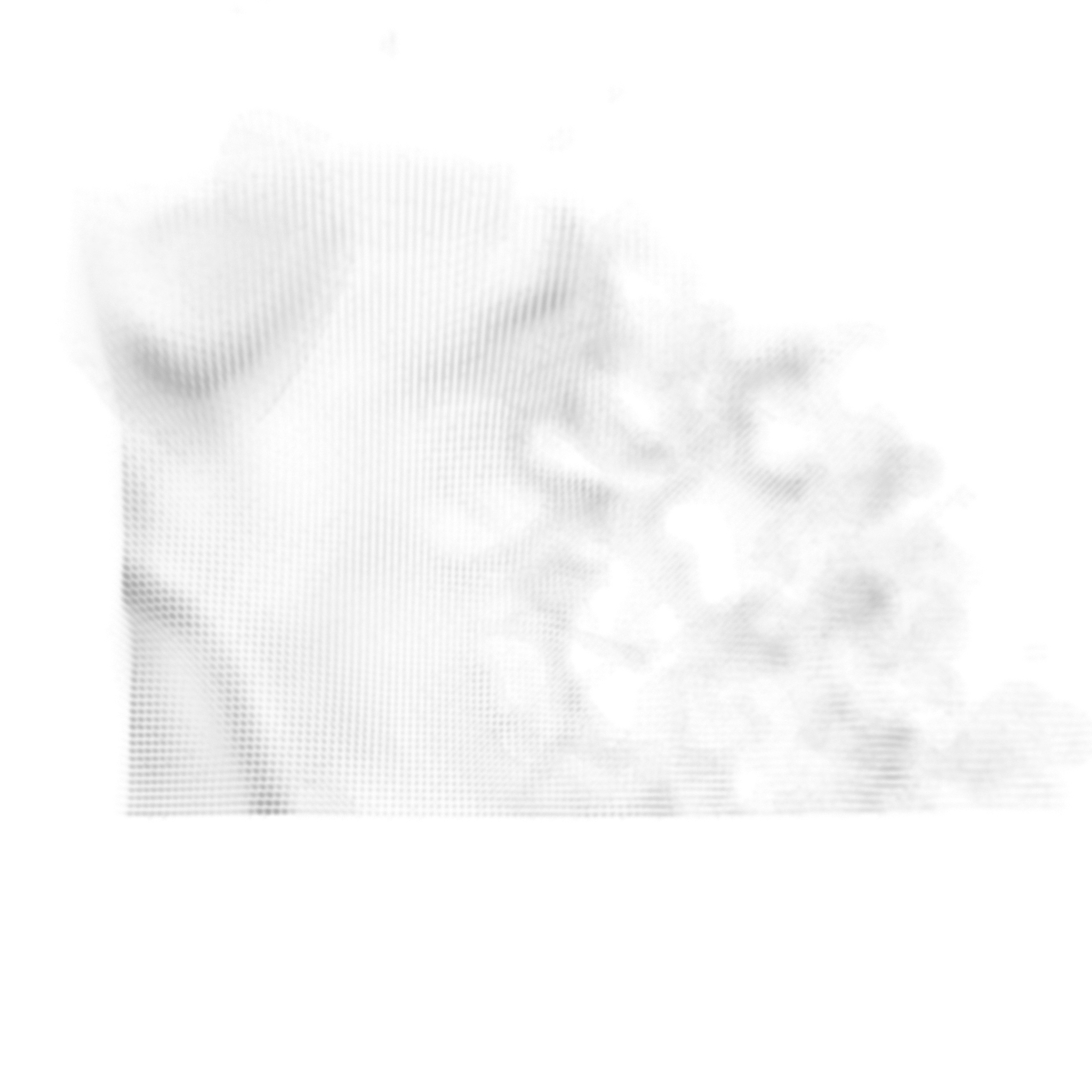

I tried using volumerasterizeattribe on a pointcloud derived from a VTK unstructured grid via Paraview.
Please refer to 2 test renders.
When the scale of the points are relatively small (x100) then the detail looks nice and continuous, but it's not the VDB resolution I want. So I tried scaling the source points up to x200. However, I'm now seeing the gaps between the points.
There is a happy medium somewhere in between, but it's not the high resolution VDB I want.
I have included a sample data subset point cloud, in case someone can show me how to get a one-point-per-voxel mapping without artifacts.
