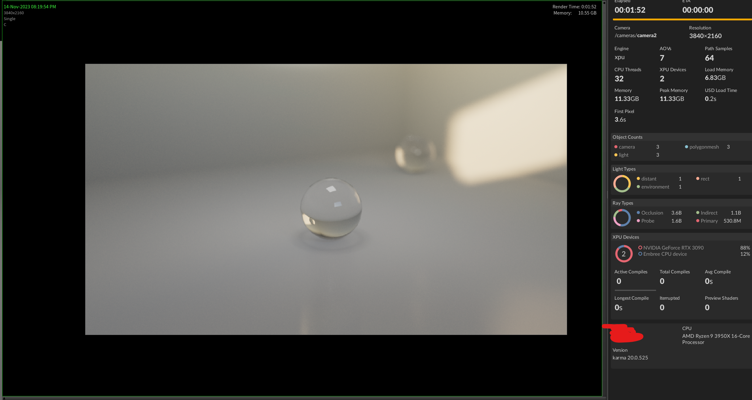

Well maybe something is wrong on windows cause it’s well slow in comparison man. I’m still trying all sorts of test and it’s slow!
And also that’s one heck of a setup, surely it would be quite fast there with that CPU and triple GPU threat. Nonetheless, it should be much faster than it is on a 3090! I’m getting more and more disappointed by the minute with each comparison!
The image Karma spits out is quite nice though in comparison to redshift. Really nice. That makes it even more disappointing! Plus all the crappy glitches and errors I have to deal with using RS. It's frustrating!

I went back to the initial scene in this thread, rendered at 4K with only 64 samples, then denoised and scaled down to HD. Maybe this is how SideFX intends for the renderer to be used. I'm hoping to hear something is messed up on windows and sideFX is fixing it. If we can render at good enough samples at higher resolution, denoise, then scale down and retain detail it's workable. I'm looking at shots posted from 19.5 and I'm certain XPU looks slower now. But I never tested it so I'm not spreading propaganda.
