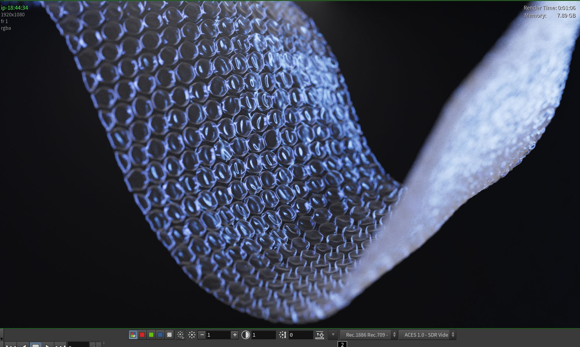

jsmack
I went and tested the bubble wrap scene with Cycles, I remembered it having similar raw performance when I tested it a few years ago. Although it doesn't have a thin transmissive material, it can simulate it with the solidify modifier by making the surface double walled. After testing, I think there's something broken with XPU, performance wise. The raw sampling speed with cycles seems to be 30x higher than with XPU. I couldn't get the result to look exactly like the XPU one though so maybe there some incorrect thing cycles is doing that makes it faster. 4096 samples takes on the order of 3-5 minutes for the bubble wrap scene depending on how many bells and whistles you enable on the material. XPU was on the order of 30 minutes for 1024 samples with the absolute most basic shader.
this is the result with Cycles. It seems to be losing a lot of energy when it stacks up in depth, even though I have indirect unclamped and 24 bounces. is it just fast because it's cheating and wrong? I would think even 4096 wrong samples would take longer than 1024 good ones.Image Not Found
this has no dof? in karma it is standard checked on

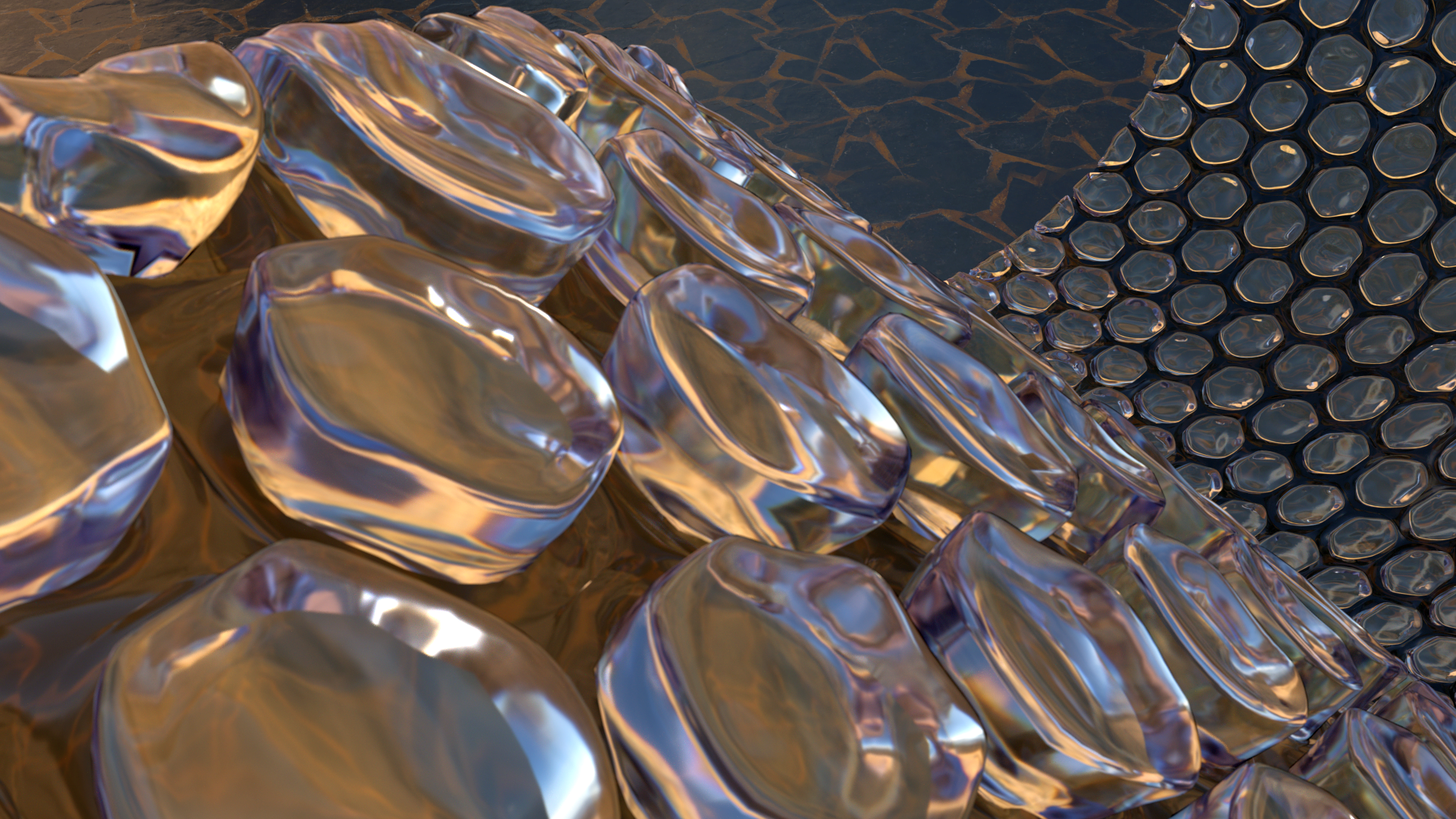

Renderman 26 w/ XPU is out for Houdini 20 and is insanely fast on scenes that choke Karma XPU (or that it can't handle the shaders in at all). Their sample "Eisko Louise" scene is a 3D-scanned face model with 2GB of textures and 1GB of misc. that ends up at almost no noise pretty quickly.
An even faster renderer is Luisa Render [github.com]. It's unfortunately not easily usable with anything Houdini will export yet so I had to hack together a similar scene. I baked out the bubble wrap to .obj after adding two more levels of subdivion in the network for a 1.7M poly model. To bias things horribly in the favor of karma, I ran it with a spectral sampling model, used a 530GB 24k x 12k HDRI background along with a physical sky, and assigned 3 different 4k PNGs anad 2 EXR files (one emission map) as materials on the background plane. Instead of the 3 rectangle lights in the original, I threw 2 spherical object-based emitters in. The bubble wrap material ended up as a layered material with the same dielectric glass with a complex IOR (build in SF5 glass) and a small thickness of 0.0001 to attempt rendering the actual surfaces properly rather than as a solid object interaction, and was sampled at 4x the rate of the rest of the scene per pixel with an additional 16 ray recursion depth. The materials were set to 0.0001 reflect weight / 0.9999 transmit weight and slight roughness. The main sampling settings were WavePath sampler with 16384 samples / pixel with a depth of 24 and ray recursion depth of 16 and rendered out at 1920x1200, which took around 3:50s with the camera shoved up against the object to maximally abuse things... as far as I can tell it converged. I didn't run any smoothing. The bubblewrap scene on karma XPU with constant folding and multithreaded optix compile turned on took 8:20 and was still noisier than heck in the areas between "bubbles".
Zoomed out to roughly where the camera in houdini was from the model, the render time is closer to 2 minutes. Luisa is GPU-only. Scene shader program compilation for the CUDA backend took about 3 seconds. There's also a DirectX 12 backend which I used to compare the speed of the 7900XTX on identical scenes and renderers which isn't really possible anywhere else. I had to hand-edit a pseudo-json scene file with some odd conventions for coordinates to get it set up which was pretty painful but still not as bad as trying to do anything in Blender.
I couldn't try any sort of equivalent materials in karma xpu since the dielectric glass doesn't appear to work (the BDSF it outputs needs to be plugged into a MaterialX Surface to convert it to the output type karma wants and the Surface node isn't supported on XPU, just CPU. The layering thing is also out but I'm not sure that it really helped. That seems like an oversight or I'm doing something badly wrong since afaik the surface node just takes a BDSF and folds some global data from the object into it and spits it out. I don't know if the dielectric BDSF is supported either though. The only rough equivalent also requires CPU and turning on the dispersion in a surface builder's transparency
This is one of the research renderers that crops up every so often, never gets real support in any software, and slowly dies. In the current state several of the more advanced integrators don't work right or I'm not using them right I suggested that they aim for USD support to gain compatibility with Houdini and they said they had already been considering it as an option so it could be used with Blender, so there is some hope for at least that.
Anyway I attached the result image from it

I'd forgotten that the layered material kinda messed up the spectral splitting, but I have a render from further away without the layering or the x4 sample count on the bubblewrap material. Apologies for weirdness with color, there's some bizarre purple shift that shouldn't exist that only happens on the bubblewrap that needed to be cleaned up, and the ground plane is positioned badly but meh, I wasn't trying for pretty here, just a speed check. Typing scene files in a format you don't know that can't decide which direction is up (had to resort to setting an initial transform on everything that pointed their forward and up vectors in the same direction) isn't my idea of fun. If you zoom in you can see that it didn't quite converge in the 2 minute render time but it came close to "acceptable noise" levels by my eyes aside from the stray bright blue firefly. It's possible from the fine structure of the spectral splitting in certain spots that the minor noise is a result of sampling above the nyquist limit on the light spectrum and it is accurate, or that another integrator would work better on this scene. One of the samples uses the MegaPath integrator at 65536 spp but no examples exist for many others so who knows. Only one of their example scenes took longer than 2 minutes on the RTX4090 and only after I raised the resolution to 4k... oddly the 7900XTX with the DX12 backend was estimating a lower render time by half on that one. I checked the 4090 on DX12 instead of CUDA and there was no difference.
One last thing I've noticed is that for certain materials, usually when heavy refraction is involved, Karma CPU is faster than XPU. It seems like if the MtlX Tiled Image node is used it might be using an image size * tile count amount of memory. If I throw maybe 5-6 2k textures on a single Karma shader but tile them at a high level I can easily go over 24GB. That makes more sense for something like the hexagon tiling node that would benefit more from baking out the mess of splotched together parts it generates but I can't see how a normally tiled material that just repeats over UVs would need it. Of course I like displacement maps a bit too much so I could just be accidentally dicing the geometry into trillions of parts, but it seems like that isn't the only time it happens.
