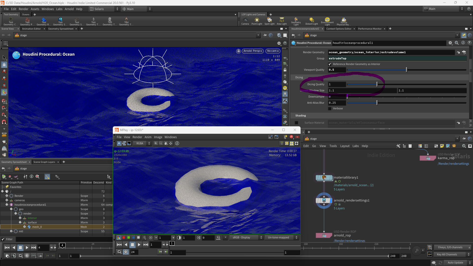

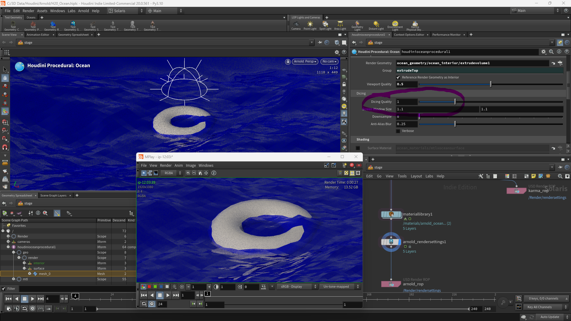

I'm doing something wrong, because, the Husk render is the same level of dicing - I'd expect it to be alot smoother/finer than the viewport.
Viewport is at 0.5 quality, Dicing is at 1.
Houdini Indie
Karma/Redshift 3D
654 posts
Joined: July 2013
The weird thing is, Dicing is doing "something", because, the RAM usage is 3gb at 0.5 Dicing, but, the RAM is 13gb at 1.0 Dicing - but the normals/detail are almost exactly the same between 0.5/1.0 Dicing.
