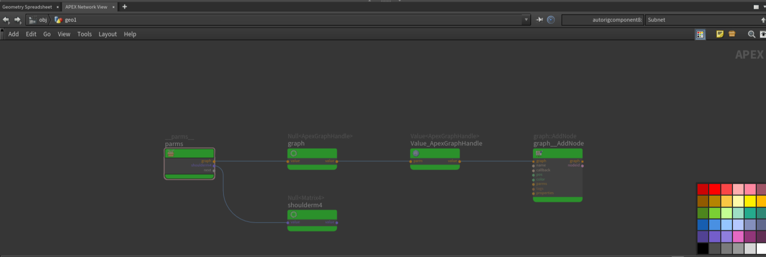

I want to use Apex scriot for modifyin existing Apex graphs and also tied to use subnets to keep things tidy. With apex graph I get this results.
I end with this graph and subnet.
with a apex script like this:
I end up with this , obviously doing something wrong
So what I the correct way to use the addSubnet function. I do not want a graph input in the result, but I can not get addNode to work inside the subnet
thank You for Your time
Martin
