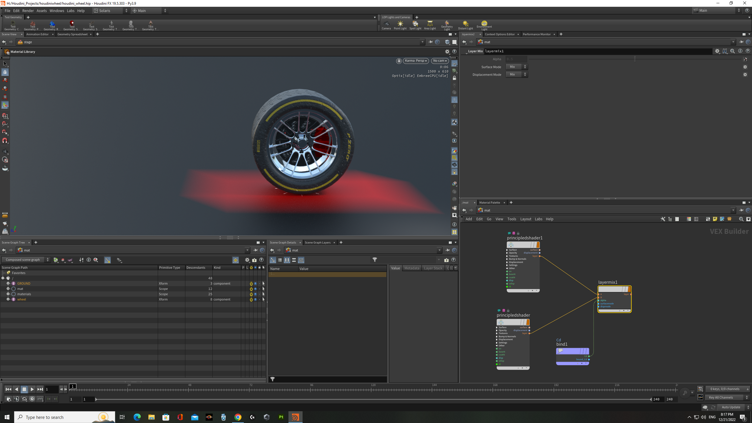

Hi everyone, I'm new to KARMA renderer, and as I see shader mix is not the same as it is in the mantra
so can anyone explain or show me a sample of how am I supposed to do the same thing in KARMA?
HOUDINI wheel.png (1.4 MB)

MtlX Mix is not supported in XPU yet

Also, that is using the principled shader.
The principled shader is only "approximated" in XPU
https://www.sidefx.com/docs/houdini/solaris/karma_xpu.html#summary [
www.sidefx.com ]
The main shading language of choice for XPU is MaterialX, where it is recommended to use the MtlxStandardSurface. In the next version of Houdini, mixing between two MtlxStandardSurface nodes will be supported in XPU.
