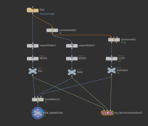

Adding my 2 cents to this discussion. I was exploring different ways for exporting animation from APEX and here's my summary:
1. Solution 1: Export character FBX (Static geometry, capture pose, animated pose)
- static mesh is brought from your captured geo before the pack folder node
- capture pose is brought from your skeleton/rig pose before the pack folder node
- animated pose if brought from scene invoke after doing the animation.
2. Solution 2: export and import channels from animation editor
- Select sceneanimate node
- select all controls in scene view
- in Animation Editor, select all key frames, Channels > Export Channels... *It samples the keyframes data.*
- select the new sceneanimate node
- in Animation Editor, select all key frames, Channels > Import Channels... *It samples the keyframes data.*
3. Solution 3: Copy/Paste keyframes from animation editor, as mentioned in a comment [www.sidefx.com] above
- in Animation Editor, select all key frames, copy key frames
- in Animation Editor, select all key frames, paste key frames
4. Solution4: Solution 4: Export and copy animation data. Since APEX is saving data inside geometry, you can save your APEX scenes as .bgeo and reuse them via scenecopyanimation node.
For convenience I've attached the hip file where I done my exploration. Find it in attachments below.
The file is not mine it's from the official APEX rig tutorial KINEFX RIGGING WITH APEX [www.sidefx.com]
I hope you find it useful and feel free to correct me if I'm wrong.
