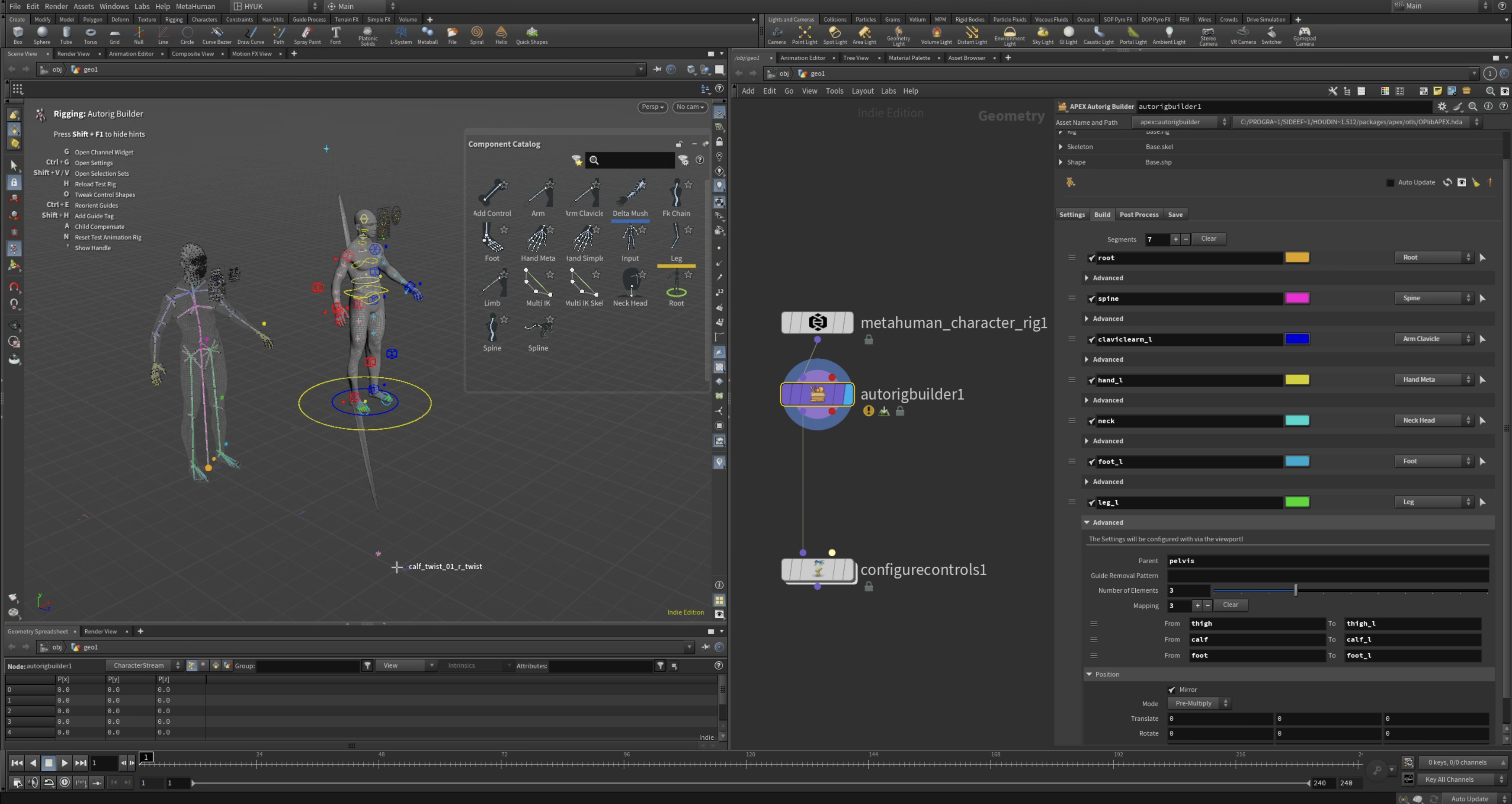

Hi Mirko,
The tags for the metahuman has been updated on Epics side and we are checking on the Autorig Builder
if you are using the metahuman skeleton and setting the tags for you automatically. It looks like our tags our now out of date.
To fix this add
* - #mh_driver_jnts
to the FK Exclude parm.
Edited by william_harley - Feb. 5, 2026 12:00:32
Screenshot 2026-02-05 185706.jpg (271.9 KB)

Joined: Feb. 2024
Hi everyone, I have a question regarding the MetaHuman workflow in Houdini.
I exported a MetaHuman character to DCC and imported it into Houdini using the Metahuman Character Rig node. After that, I used the APEX Autorig Builder and dragged a "leg" component from the catalog to set it up.
The problem is that after updating the builder, the calf_twist_01_r_twist joint is not in its correct position (it seems to be offset or flying away).
Has anyone encountered this issue? How can I fix the placement of these twist joints when using the Autorig Builder? Any advice would be greatly appreciated!

146 posts
Joined: Oct. 2023
seunghyuk2023
Have a look at the post at the top, you might be missing the fk_exclude string for metahuman.
