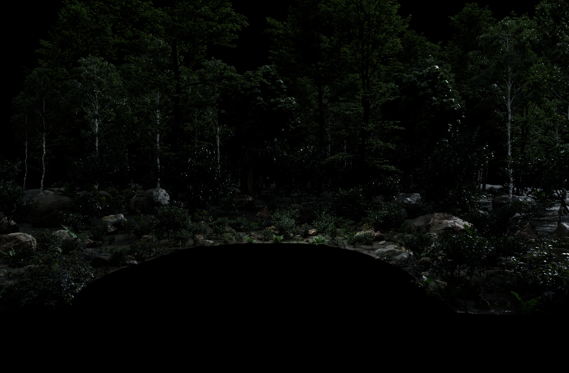

It took me quite a long time to get to this step. I created a whole USD pipeline for this, even though I am working on it only solo. This is probably overkill, but I want to work in a production setting to feel more comfortable with USD in the future. Until now I mostly did FX in Houdini, so setting up a complete and robust pipeline was new. But when set up correctly its a lot of fun.
- Shot based project structure
- Asset library file to save out all the components & master materials to be referenced.
- Creating subnets with custom parameters, where I only need to change one string and
all the files get pulled in automatically
- Master Materials for different assets types saved as USD
- Component for assets ( trees, plants, rocks etc )
- Variants for plants
Assembly layer files:
- Environment Far
- Environment Mid
- Environment Close
- Rendering File ( includes Lighting )
- Environment Far
- Environment Mid
- Environment Close

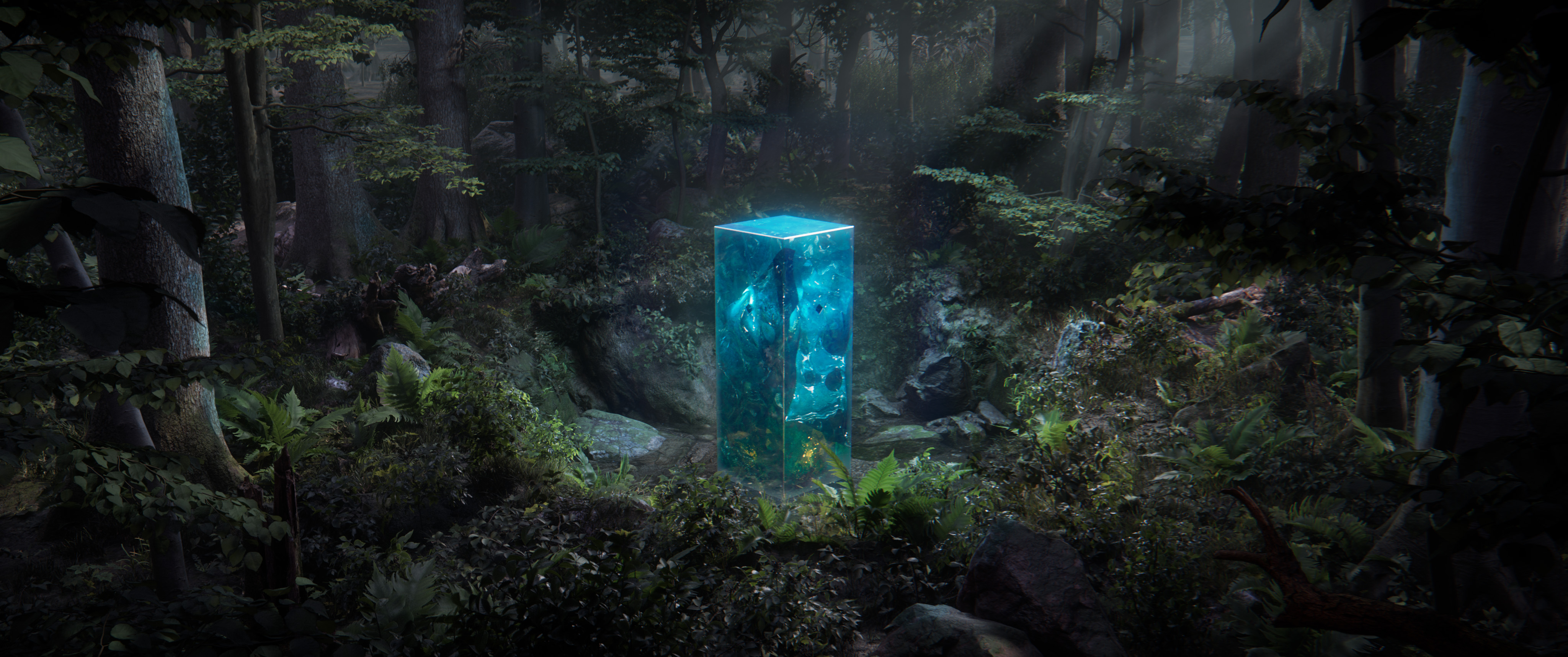

I worked on the crystal. Basically its just a fractured shell with translucency, two noised up meshes and some smaller debris. I didn't use any volumes to save render time.
There are some great tutorials about crystals on Arvids channel [youtu.be]
