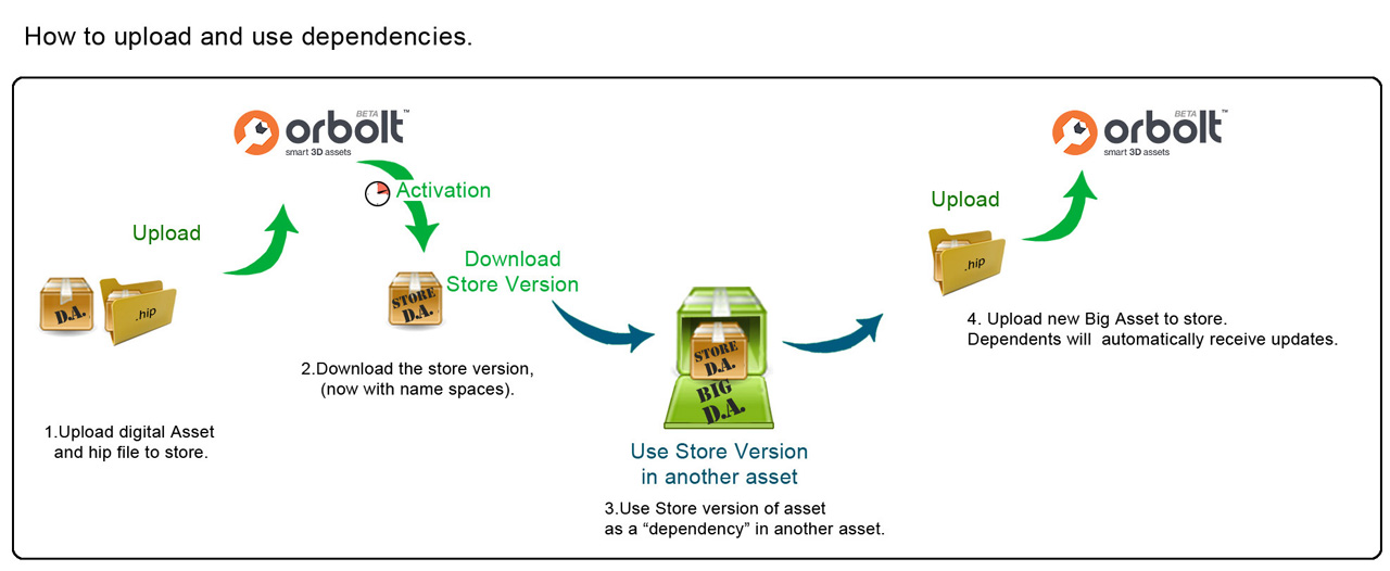

- compositor
- 237 posts
- Joined: April 2011
The image below illustrates the relationship between the main asset, it's dependencies, the .hip file, and how their upload is managed.
The dependency (labelled “D.A.”) is uploaded to the store.
It gets activated
The store version (labelled “Store D.A.”) of the file is downloaded and used in a main asset (green “Big D.A.”).
The main asset is saved and uploaded to the store.
It gets activated
It gets activated
