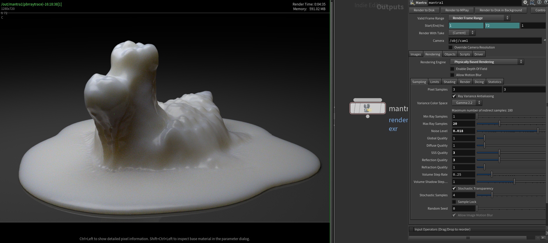

@Olaf Finkbeiner: Yes, that's what I mean, there are ways to some of these things in other renderers (including vray) but it's nowhere as easy as in houdini. No need to write custom plugins or scripted workarounds.
I would gladly trade in half of vrays render speed for half of mantras capabilities, but we're quite far from that.

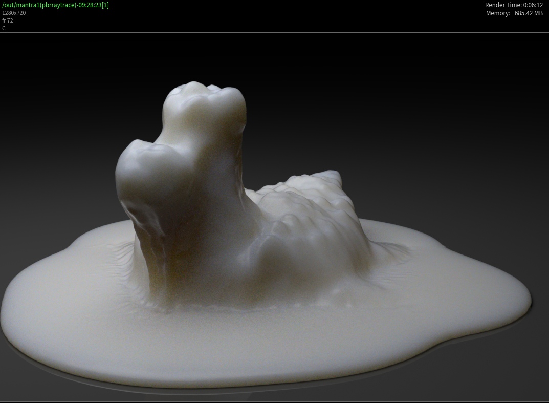

I may actually have to correct myself here. I just rendered an SSS scene where I was completely sure the difference is huge. Turned out, it's “kind of” not as much as I thought (at least if everything is purely raytraced). The scene does not have any GI turned on, just one area light. Mantra took about 4.5 minutes on my machine and has some colored fireflies here and there (which are actually getting way worse in the shadow areas, see below). I tried to optimize the settings best I could, with lowest possible render times as a goal.
Same scene brought to max and vray did yield some varying results. I'm do not know how SSS is calculated in the disney principled shader, so I rendered several versions - with the VRayALSurfaceMtl and the VRaySSS2 material. ALSurface is raytraced by default, I made sure the SSS2 one is set to pure raytraced too (for fairness). Vray is around 2 to 3 times faster, with a more even noise distribution. The SSS2 variant with 1m42s looks closest to the mantra rendering to me, but this is obviously subjective.
It's not the difference in render times I wanted to show, but I thought it is fair to share it anyways. Let me know if you think there is something I could try in mantra that could help.
I know of course that there are plenty of things that can have an influence on render times. The render time difference is also not as much as I thought, so I wouldn't count this scene as a good example.
Ok, attachments are a bit chaotic here. In order:
- Houdini mantra 4:35
- vray alsurface directional 2:24
- vray alsurface diffusion 2:04
- the shadow fireflies in mantra
- vray FastSSS2 1:42
Edited by racoonart - Oct. 12, 2017 11:29:23

55 posts
Ok, I have attached the scene, in case someone wants to play with it. I only included the cache for 1 frame, so you need to render at frame 72.
Btw, I invite everyone to contribute to this thread with example scenes.
@amm, Olaf Finkbeiner: I tried the SSS in the classic shader, it's not faster however. I made a test with slightly lowered noise threshold to be closer to Vrays result, see below. I did not try the deprecated mode yet. Will do that next. I started with H16, so I have no idea how it was before (edit) I can't seem to find a spectral gradient setting anywhere, I also have difficulties matching the look with the PhysicalSSS. Maybe you can have a try, amm?
@martinkindl83: That kind of matches my experience. We are a small company but do a lot of rendering. If we can somehow speed up that process, we do it, even if that means a bit more manual preparation on the artist side. The shot I mentioned above took a bit over 2 weeks on about 20 machines, 10-20 minutes each frame. Even a 50% render time drop would have made delivery difficult (or way more costly, buying more machines).
@cpb: Not wanting to abandon Mantra is exactly the reason why I started this thread in the first place I do not want to use a 3rd party renderer if possible. I'd like Mantra to be that “uber” renderer it is feature wise … it just needs a bit more speed. You are mentioning Simplicity and Reliability: I didn't include my Redshift results here because of these very reasons. I think Redshift is reliable, but less well integrated and you need GPUs in your render farm (which we do not have). The render times however are blasting away pretty much everything. It took just 15s to get a clean image in that particular case - but as I said, it's not my intention to compare apples with bananas.
Edited by racoonart - Oct. 13, 2017 04:30:14

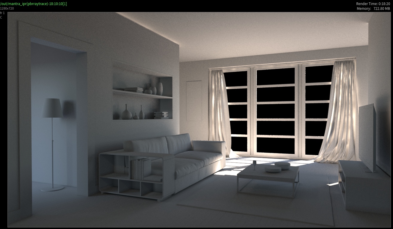

Ok, next scene. This one was provided by Ludvík Koutný and is available here: https://corona-renderer.com/forum/index.php?topic=4354.0 [corona-renderer.com] . The scene may be used for testing purposes but may not be sold or used as a portfolio piece (which I think shouldn't be necessary to mention). You can find my exported version in Houdini below.
A typical interior, a rather easy one to render. Some notes about it:
- I have setup the portals in a way I think makes sense. I'm not sure what the official workflow is meant to be but I found it rather cumbersome (compared to other rendering engines).
- I'm using a GiLight for secondary bounces and (obviously) Pathtracing for the first bounce. I did the same setup in Vray, Brute force + Lightcache (mostly defaults).
- I've used a style sheet for the material override in houdini and specified a viewport selection (for some reason the scene blow up when I just used * as a path value, maybe something related to the portals?)
- I have tried to get both images as clean as possible in as little time as possible. In vray it was pretty much just open scene and press render, in houdini I did quite a bit of tweaking. It's still not as clean as the vray render. I also have a lot of issues with the photon map since the photon samples get interpolated through geometry (which is prevented in vray by retracing those close-proximity areas).
- I also get light leaks in the upper left corner, the little white pixels are primary rays, this should not be happening. I decreased the raytracing bias to 0.0001 which helped (it was a white line before), but didn't want to set it to complete zero since I don't know how it would affect other raytrace operations.
So, long story short, pictures in order (rendered on an i7-5820K @3.3Ghz (6 cores, 12 threads)):
- Vray 5m28s
- Mantra 18m20s
- Mantra photon map issues and noisy areas
Please let me know if and how I can optimize that scene and get better quality especially in the GiLight.
Edited by racoonart - Oct. 13, 2017 14:20:47

Regarding the interior scene: It´s not in scale (usually 1 unit = 1 meter). Also you can avoid light leaks by giving walls and ceiling some thickness.
