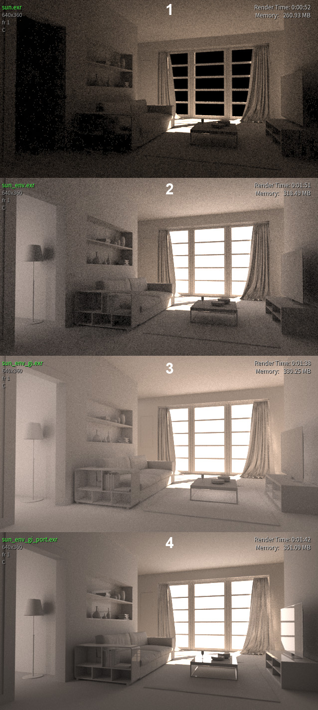

@RobotHeadArt: I rather avoid comparing to redshift. I'm using the demo and it is reaaaally fast. I also did some comparisions in max recently, with a complicated interior scene and it performed very very well (careful, facebook link: Redshift vs Vray/Corona [www.facebook.com]. The thing is that you need a gpu renderfarm, which is not going to happen for us any time soon, so I tend to stay with cpu vs. cpu renderers. However, I have to admit that redshift is closer to a cpu renderer than any other gpu renderer. Others are not remotely as powerful as redshift is (out of core, irradiance cache, etc).

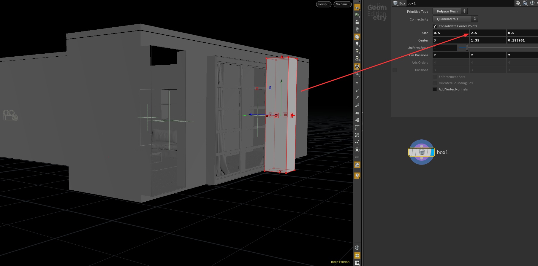

@Konstantin Magnus: I'm not sure what you mean, if I add a box and measure the height, it looks fine (see below). Is there some “scene unit” setting I don't know about?
Either way, incorrect scale is completely unacceptable in a production scene but technically this shouldn't matter in my case. All the lights etc should behave the same way.
Yes, giving all the walls thickness helps, but that's missing the point. The scene works fine in other renderers (like vray and corona), and I even cheated here in houdini (I expanded the ceiling to make it actually intersect, it didn't in max). So ideally it should work with Mantra too.
@cpb: Thanks for the effort! Unfortunately you completely miss the point here. Faking it old school with placing bounce lights is really not how you should have to work (it can make sense if you want to create a specific look, but not for trying to “make it look ok-ish in reasonable render time”). If I did the same thing in Vray I would definitely be below 1 min rendertime.
However, I find your scene interesting, there are some thing you did there that I need to have a closer look at. I assume you exported the scene as a .bgeo and reimported it?
@harryabreu: I don't think that video is giving a realistic comparison. I read some comments under the video which seem to agree
. The purpose of this thread here is to provide scenes and tests to proof that there is indeed room for improvement. The test in the video above doesn't help with that (and is very biased imho).

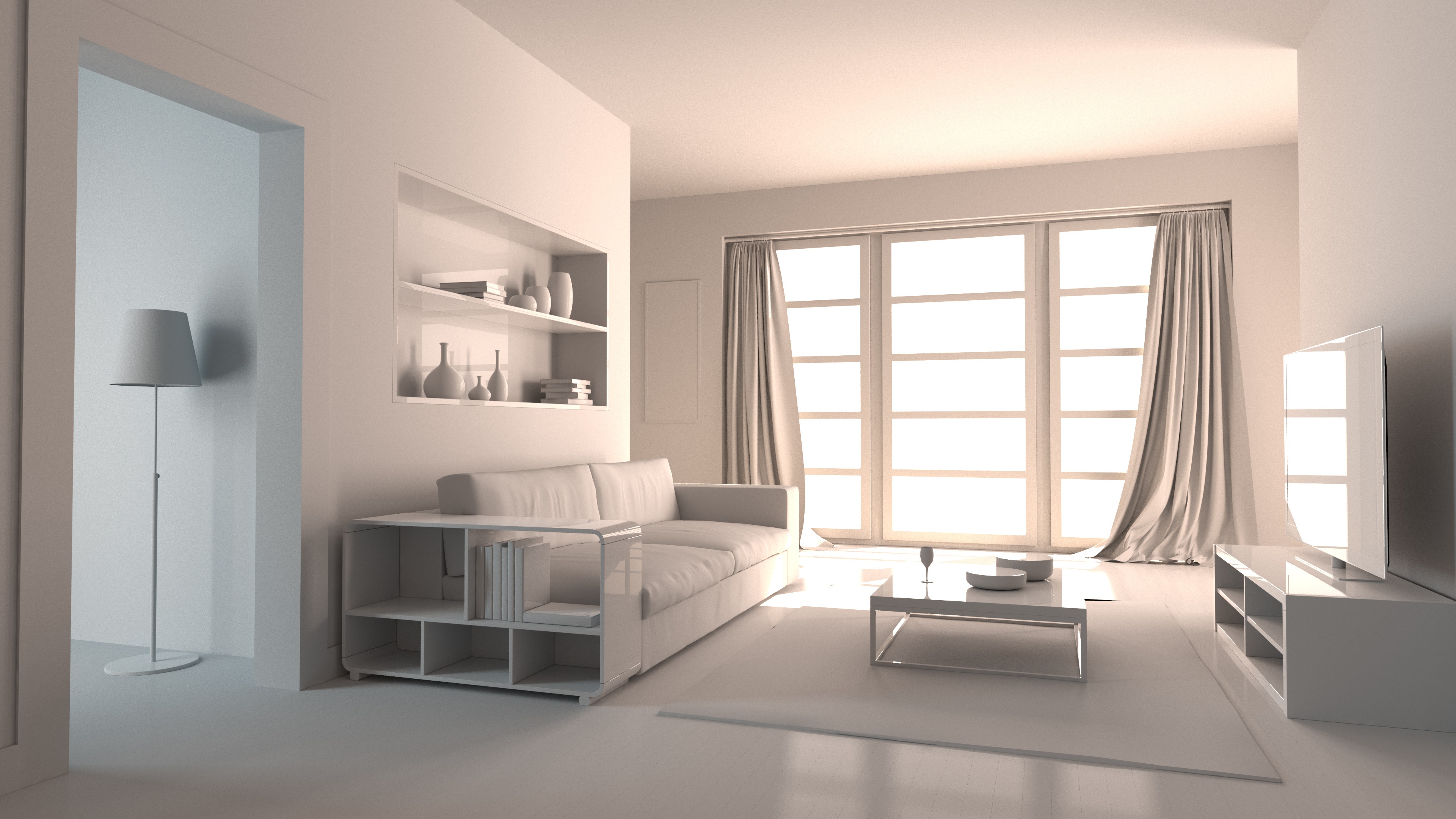

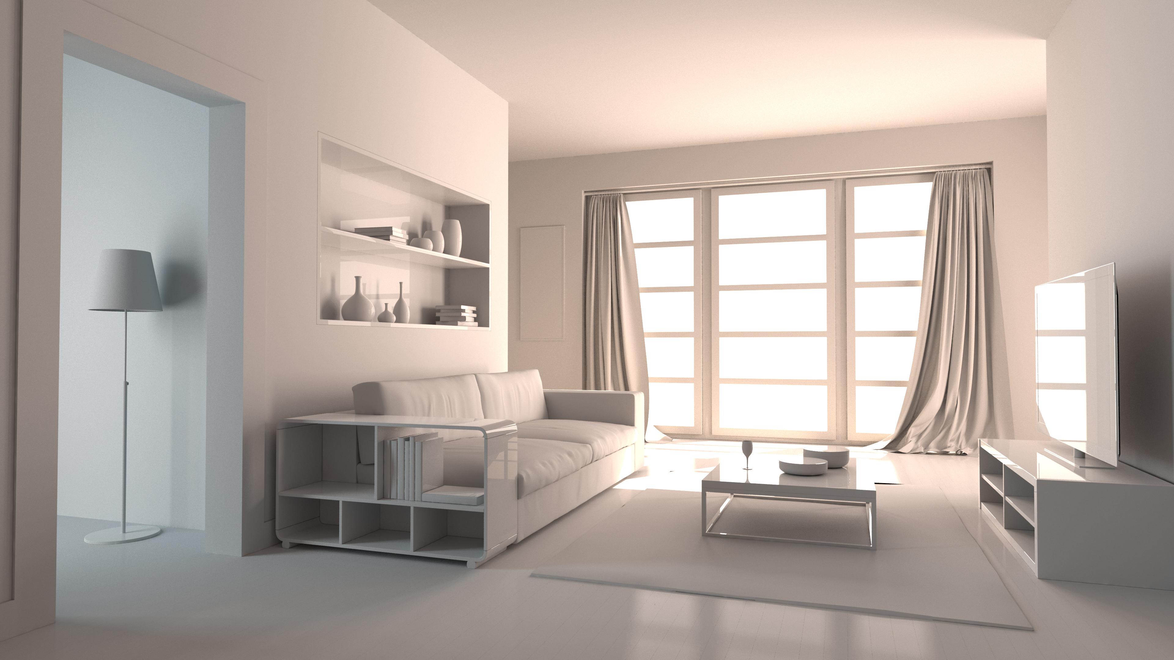

Hi everybody,
so can we conclude that Mantra currently does not excel at GI or indirect lighting?
I think so.
But cpb showed that you can “fake” it quite nicely in Houdini with Mantra. The use of the “attenuation ramp multiplier” is quite clever and i have not seen this feature in any renderer that i used before.
I deleted all the fake bounce lights and used a GI light instead. It works but i am at 10minutes plus 3-4 for the photon map again.
HDR lights is something else where i think Houdini with mantra is great. I build my own HDR studio light setup. I can even render HDR 360ies in houdini with mantra (no need for hdr studio software). And i can finetune the hdrs in cops (no need to go to photoshop to desaturate or blur…
I could go on and on like this…
So obviously i would love for Mantra to be faster. And if i had to do classic interieur archviz i might use vray or if i had to render cars i might use deltagen or vred. All renderes have their stronger and weaker sides. And its not speed only that makes me choose a renderer. Its also scene setup time or features. And especially to all the indie users. SideFX is treating us so great! 200$ per year compared to 600$ for a year licence of Arnold.
For what i am doing currently, Mantra in Houdini is just the perfect combination. Its fast enough for me.

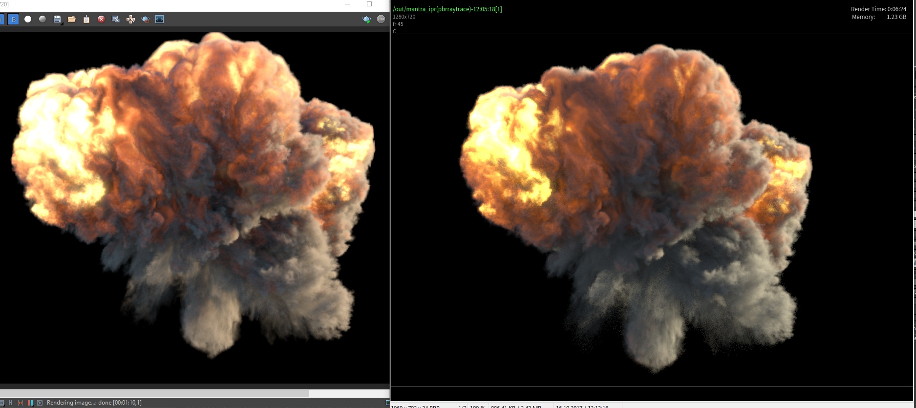

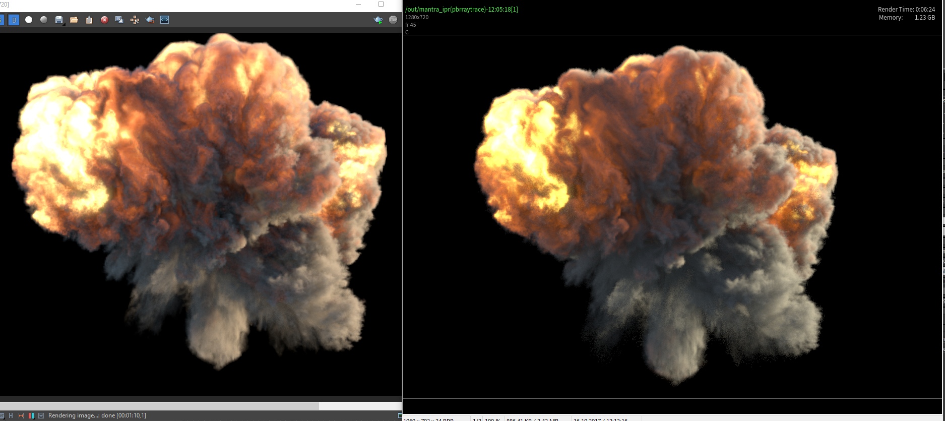

@Olaf Finkbeiner: cpb's solution is clever but completely unacceptable as a “workaround” for a modern renderer.
The problem is not just speed. That would be bad enough but you cannot reach the same quality as with other renderers. The curtains in the Interior picture still look very bad and there will be light leaks from interpolated photons on smaller details.
I'm not arguing that SideFx is giving us great value for little money, especially with the Indie license - but that doesn't mean we should stop here. Mantra is, in my opinion, one of the weak parts of Houdini and I don't think anyone would disagree that improving it would be much appreciated. Again, this thread is here to help them identify problems, not to just rant without solid evidence.

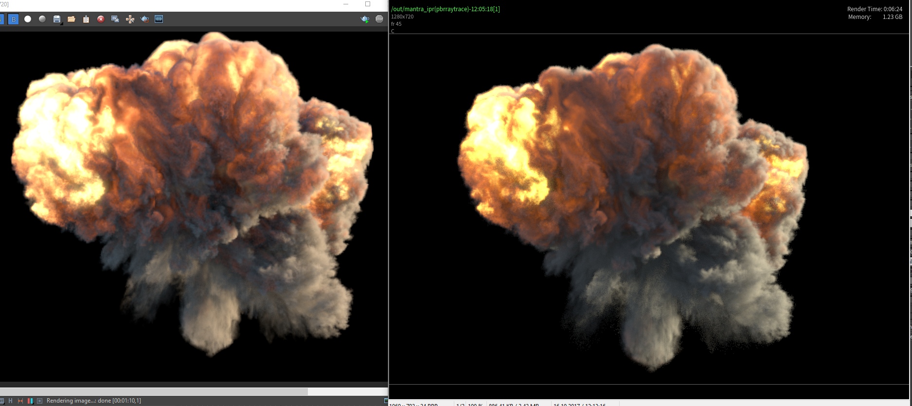

Here are the next examples. Typical Houdini work, a standard pyro explosion from the shelf (with some minor adjustments). This time I didn't try to disable all the approximations and caches in vray to match Mantra because that just wouldn't make sense. They are here to make rendering faster and as long as it looks as good as without I don't think you should disable them - it's all about the result anyways. I first did the Houdini sim and render and then tried to match it in Vray. The defaults in Vray are way lower and render in a few seconds. I increased several settings to something I would call “usable for production”. Takes around a minute, wheres in Mantra it takes a lot longer and is still not good in my opinion. Settings in Mantra are mostly default, just Volume limit set to 1. The lower smoke twirls are very noisy. If I increase stochastic samples or pixel samples, the render time will go up a lot.
Scene without the cache is attached. Just simulate to frame 45, doesn't take long.
The next scene will be a lower density volume with a bright light close-by and GI enabled. That's something that is practically impossible to render in Mantra in reasonable time (coming back to the “it's not just speed” argument). (edit: actually, I seem to be incapable of reproducing the issue I had a few days ago, may have been an error on my side. My tests render well with a reasonable color limit. Unfortunately, I don't have the original scene in question anymore. So, forget what I said
(I've been eyeballing the emission, gradient and density values in Vray, so there are some visual differences)
)(I've been eyeballing the emission, gradient and density values in Vray, so there are some visual differences)

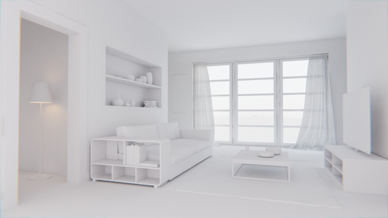

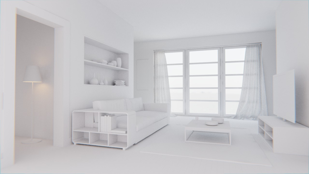

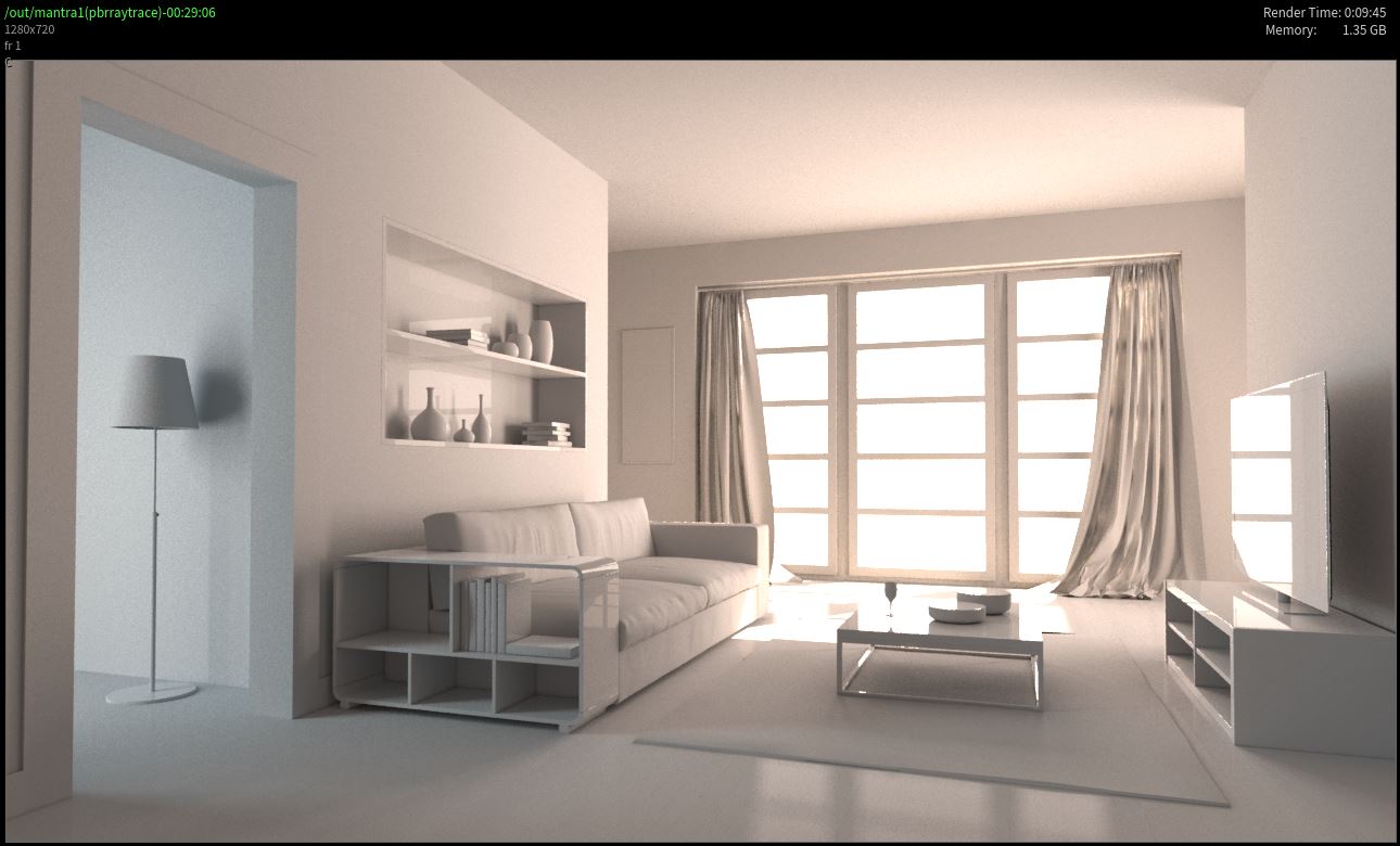

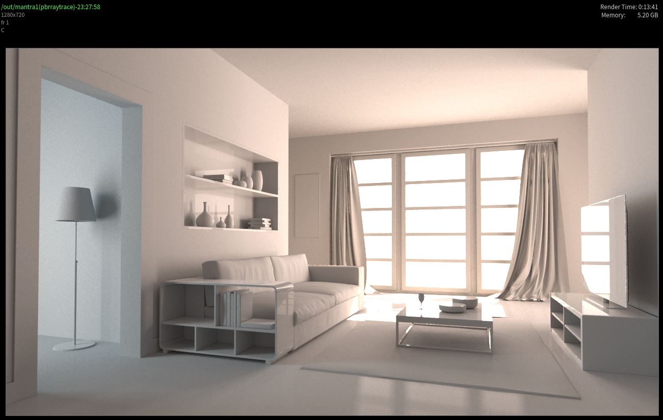

Hi nice Houdini Forum people,
please find attached the scene mod from cpb.
I deleted all the fake bounce lights and the ambient. The rest of the lights are like with cpb scene.
I also changed the curtain a bitz but that was not realy necessary to get rid of the gi blotches.
I don´t like the GI workflow (maybe i understood something wrong)
What i do:
i have to mantra render nodes one for photonmap generation one to render
the difference is the diffuse limit. when generating the photonmap i turn it up (in this case to 10)
On the light i turn auto generation on and off (not sure here but i did it anyway)
I did not check if other values would be faster i just wanted a clean photon map.
The map without prefilter gave a cleaner result.
Also i saved the photonmaps to disc and they are huge! I have a fast m2 ssd!
they are: and its 5-6 gigbytes
I could not find a way to do this without saveing the photon map. I mean the 1 diffuse limit for rendering and 10 for photonmap generation. Maybe i could do this with light quality settings?
I think this can be optimised further but i did not do it here:
http://www.sidefx.com/docs/houdini/props/mantra [www.sidefx.com]
Photon target
Houdini vm_photontarget
IFD light:photontarget
When sending photons from this light source, this is the category expression to determine which objects will receive photons.
Photon weight
Houdini vm_photonweight
IFD light:photonweight
Controls the proportion of photons that should be generated by this light relative to other lights in the scene. By default, all lights have an equal weight of 1.
Photon modifier
Houdini vm_photonmodifier
IFD object:photonmodifier
Affects the way that photons are traced through the scene. When a photon hits a surface the parameter affects it depending on the selected option. This is only used if the scene has a light (such as the GI Light) that uses photon mapping.
None
Photon is not modified, bouncing as usual (this is the default).
Pass Through
Photon passes through the surface, not being stored.
Block
Photon is stopped, ending the path trace for that photon.
What i do:

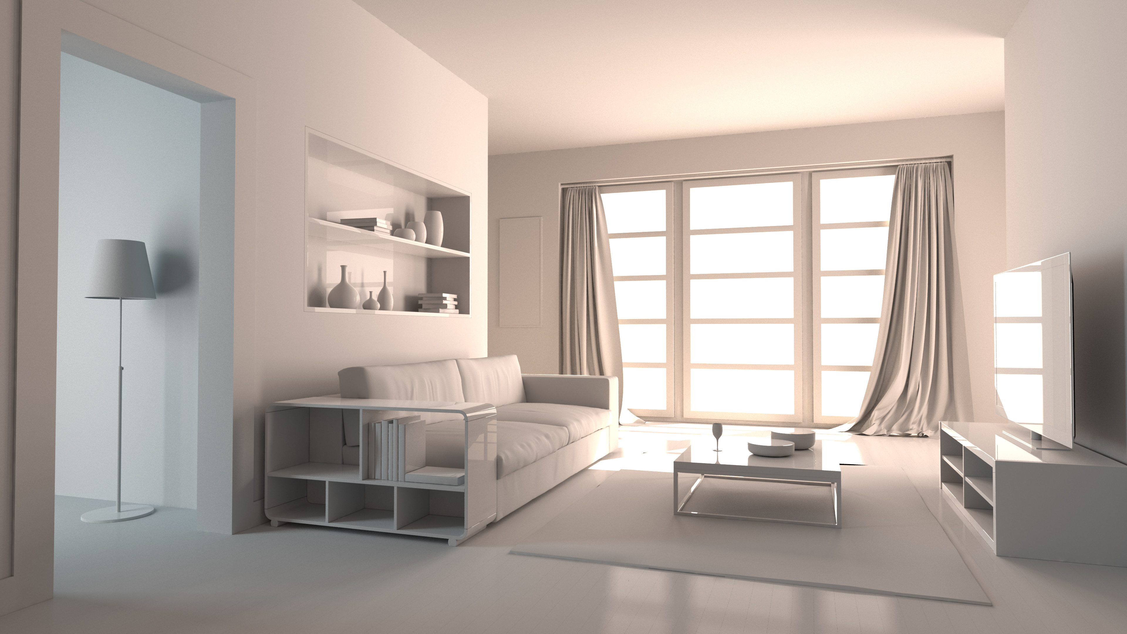

For interiors, just use PBR, Area lights to fill (unchecked Normalized area and with Physical falloff). Help path trace with photons using GI Light. I usually do not go more than 1 mil photons and sometimes change Filter to 5-10, that is all I change from default settings. Use Environment light with HDR and if you have windows opening use Portals. It is, of course slower than Corona, but not significantly. Corona has better GI so it gives more pleasant results, but that is because it is optimized for arch vis work, it can not do half of the stuff Mantra can.
This image was rendered in 12 min, with default sampling setting and PixelSample at 4x4, Diffuse limit 3 and Color limit 5. On laptop with i7 4860HQ. Photon count was just 10000.

Hi @SreckoM, thank you for the tips!
I worked from @cpb's file and removed all the other lights except for the Sun.
Then I tried to somewhat follow your suggestions:
Here were the stages of lighting, and the attached images below:
So far its looking good, only two issues I would like to address.
By the way, great and informative thread!
Regards,
Jeff
- Created a new Mantra ROP
* Set to PBR
* Override: Half-res
* Pixel Samples: 4x4
* Diffuse Limit: 3
* Color Limit: 5 - I skipped creating an Area Light for now.
* I wanted to see how the outside light goes in the room. - Added a GI Light
* Photon Count: 10,000
* Filter Samples: 8 - Created an Env Light
* I did not use and HDR for now.
* I got the light color and intensity values from the lightcolor shader.
* Deleted env Object (because I'm already using an Env Light) - Added Portal Objects
* I used this for the enironment light.
* It was cool seeing the effect of the portal on how it really helped focus the lighting and lower the noise.
- Sun
- Sun + Env Light
- Sun + Env Light + GI Light
- Sun + Env Light + GI Light + Portal
- Noise:
In playing around with it, I was only able to fix the noise by basically increasing Ray Samples.
Are there any other parameters I could set to lower noise? - Area lights:
Should I have added some Area Lights inside to help with the noise? How did you get such a smooth looking render @SreckoM, I would love to see you file if possible
- Curtains:
The odd looking indirect lighting from the curtains seems to be coming from the low and filtered Photon Count. I could increase it. But I was just wondering if there are other factors that is affecting this?
Regards,
Jeff
