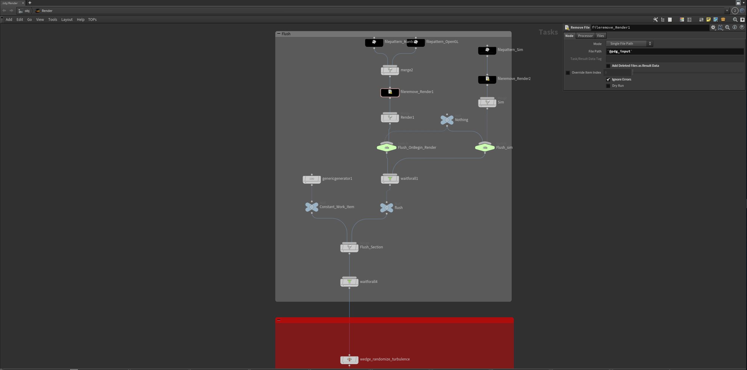

There example Flush/Remove All files from Render Folder or/and Sim Folder on Begin
So this is nice example, so here on the right side I have nodes pattern file map which is render and sim files, and if Your folder is contain something and this is true its pass and add work item, so its very important to add generic generator to make constant work item, because if Your folder empty and this is false its no any work item generation, and its must stuck and its might stop and don`t move downstream.
About waitforall node…
its very important add waitforall node, because if You execute it again,and this is true its will remove files and add work item and if in plans using wedge(where You set it for example 3), its add extra 1 work item, and its get You 4 items and its going to mess….
Another Example Flush/Remove Files after creation Video if under need
