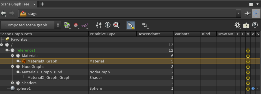

Did you manage to get this to work? I've downloaded the Marble_Verde_Guatemala_Slatted material and used a reference node to bring it in to lops. When I try to assign it to a sphere and render in Karma though it doesn't seem to work. I'm assigning the MaterialX_Graph material, under Materials. Am I doing something wrong?
(using Houdini 19.0.455 apprentice)
Screenshot from 2022-01-05 15-44-57.png (55.5 KB)
Screenshot from 2022-01-05 15-46-10.png (53.0 KB)
