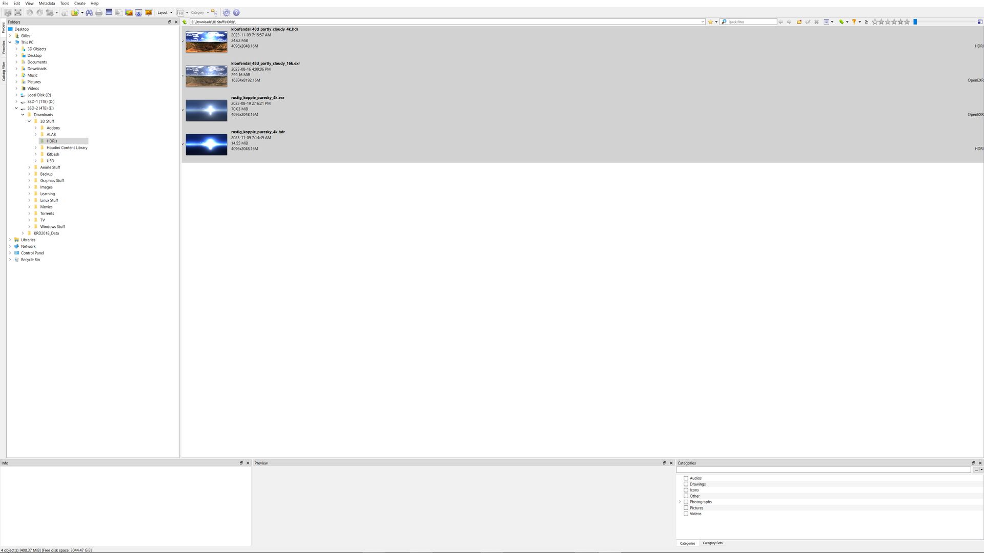

Image preview. In Windows I use FastPictureViewer where I can scroll through dozens of 8k textures or 150MB HDRI images in a second. On linux the Gnome Viewer and other software I tried are just so slow. EXR is not supported by default.

- In Windows, you use a custom program to read your EXRs, why not do the same in Linux? I use Xnview, works great, there is also DJV, chaos player and mrviewer2 just to name a few.

Image Viewers for 32-bit HDR Images
Image viewers like
24 GB of VRAM available in RTX 4090 which you own will allow you to store slightly above two dozens (29) of 8192x4096 floating point OpenEXR pictures directly in VRAM. Once VRAM fills up, the program will again need to pull the data from storage memory. I don't think it's different on Windows, so I understand that "dozens of 8k textures of 150 MB HDRI" was a hyperbole.
There are probably plenty of other fast image viewers with HDR and EXR support for GNU/Linux. Gnome Viewer you speak of is unsuitable for any production work. Treat it more like a basic image viewer for home use, but even for this purpose I find other programs much better (like
Image viewers like
tevand HDRView, for instance, allow for rapid scrolling through sets of 32-bit floating point images. Of course images are preloaded into VRAM first, so a fast SSD and vast amount of VRAM is required. Otherwise, you risk slow disk read times or choking up memory of the graphics card.24 GB of VRAM available in RTX 4090 which you own will allow you to store slightly above two dozens (29) of 8192x4096 floating point OpenEXR pictures directly in VRAM. Once VRAM fills up, the program will again need to pull the data from storage memory. I don't think it's different on Windows, so I understand that "dozens of 8k textures of 150 MB HDRI" was a hyperbole.
fehto name one). However, neither Gnome Viewer nor fehsupport OpenEXR format at this point of time. Which reminds me to make appropriate feature requests.OpenEXR

Thanks for all the replies! Those were very helpful. I actually switched to POP OS and I didn't need to boot to Windows for a few weeks now. Slightly more complicated setup but once it's done it's rock solid and definitely faster than Windows.
QIMGV is pretty nice tool for previewing textures since it preloads them into memory. I often need to look for roughness, bumps and HDR maps.
The only minor thing is that I wasn't able to solve how to generate thumbnails for .hdr image files in GNOME. This works out of the box in KDE but GNOME probably needs some additional library or tool to be installed.
