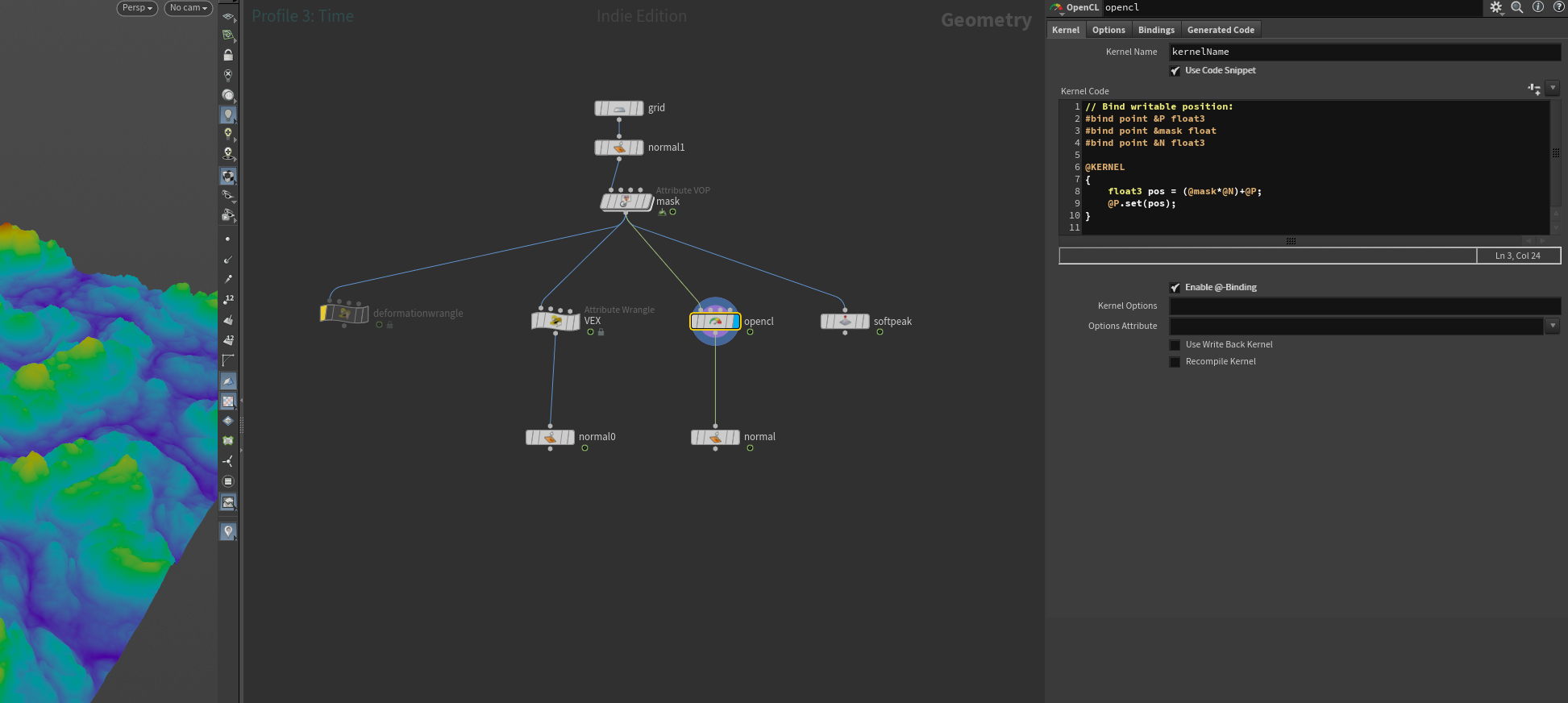

Here's an example comparison I did to test how fast the improved OpenCL SOP can be. To be honest I am a bit disappointed, as VEX is clearly the winner among those 3 different ways do displace a grid. Not sure if I did something wrong or inefficient. The OpenCL Code is very simple but shows how to bind incoming attributes and displace along Normals.
With VEX I get Draw Time around 30 FPS
OpenCL clocks in at 16 FPS
and last but not least SoftPeak at 27FPS

Here's an example comparison I did to test how fast OpenCL can be. To be honest I am a bit disappointed, as VEX is clearly the winner among those 4 different ways do displace a grid. Not sure if I did something wrong or inefficient. The OpenCL Code is very simple but shows how to bind incoming attributes and displace along Normals.
Thanks for the answer! Yes, I also put together a similar example (moving the grid), and as a result, Open CL performance approached VEX performance only when using millions of points. I think this is not the best scenario when using this node. I think that a lot of time is spent on compilation and other side operations, and that the real gain can be obtained when a long complex algorithm is executed inside OpenCl.
It seems to me that a task that will be performed well in Open Cl must involve intensive work with memory, since video memory is usually many times faster.
