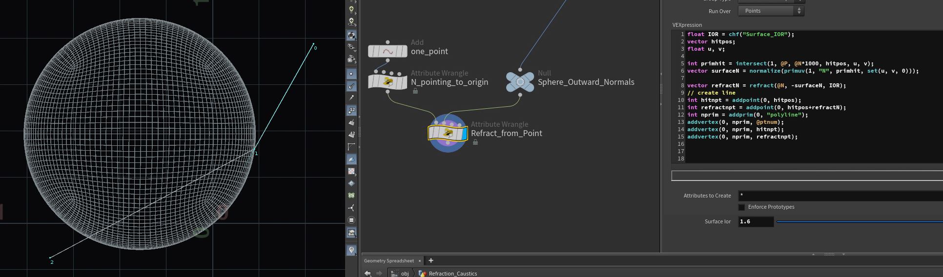

1185 posts
hmm... that's odd. we do things differently. I start with intersect to get the surface normal before I use refract.
EDIT: I'm confused. In your example, the IOR is below 1...?

I'm trying a simpler example and I still get weird results. My InAngle (theta 1) is 45 degrees (makes sens) but the resulting OutAngle (theta 2) is 135 when it should be less than 45. What am I not doing right? What am I not understanding?

8188 posts
Joined: Sept. 2011
olivierth
-Olivier
the refract function doesn't take the IOR of the medium as an argument, which you've put in as 1.6
It takes the ratio of the outside medium to the inside medium, for air and glass it would be 1.0 divided by 1.6
https://www.sidefx.com/docs/houdini/vex/functions/refract.html [www.sidefx.com]
1185 posts
Oh, that "N1/N2" might be where I'm goin' wrong!
