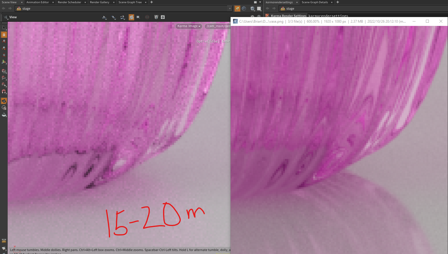

Houdini is amazing. The only thing I desperately, desperately wish is for Karma (normie and/or XPU) to be faster. I'm cranking out tons of renders in Maya and Arnold now, won't win any speed awards but it's useable. I tried the same scene in Karma XPU (XPU!) and it was EIGHT times slower than Arnold to get the same noise level. It's the difference between finishing a set of 20 stills in 5 hours versus 40... I love how Karma looks and I love Houdini, but I just flat out can't use it for the projects I'm doing right now. It's a shame.

Here's a quick comparison in the scene I'm working on now. Matching time: 15-20m to Arnold finished frame compared with 15-20m XPU, around 500 samples. Cleaning up XPU to match noise level requires 2000+ samples, looking at 1.5 hours or so.

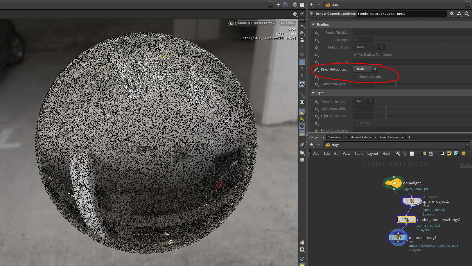

Oh, and I should clarify this comment here.
"direct refraction subset" didn't do much for your scene, but that doesn't mean it doesn't do anything. It does help in other refraction-related cases. Here it is applied to a glass sphere with a dome light with HDRIHaven_skylit_garage_2k.rat, rendered with sample-count of 1.
It's been implemented in KarmaCPU for a while but is now working in KarmaXPU. Sadly due to the large amounts of code changes, we are unable to back-port it to H19.5, so it'll have to get released in the next Houdini version.
